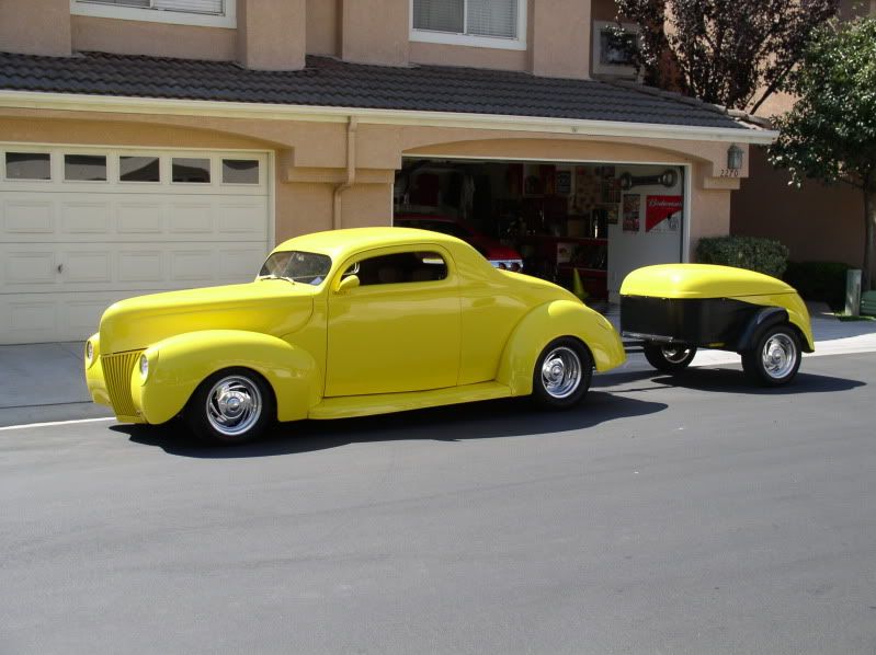

    Default Towable Trailer Question
    Never having towed a trailer behind a motorcycle, I'm curious whether the one I use behind one of my Street Rods is doable? I have this trailer.....
    It has very little tongue weight at all, it is capable of hauling 600 lbs. and is 30 cubic feet.
    I would like to use it because of the 15" wheels. I'm just a little concerned it may be too large. at 65" wide. My TriGlide is 60".

    Your trailer looks a lot like Motor trikes trailer... Might have to add a sway bar but cant see why not !! Reese makes a kinda inexpensive sway bar I use it for my 35 foot bumper pull... It works great just can't back up with out taking it off.... But that is with a trailer that weighs 11,500 lbs..Also might catch a little wind !!

    With the amount of weight you will be pulling you will NOT need a sway bar. I pulled a camper that was about the same width as your trailer and it was half again longer than the one you have. Just make sure you have enough tongue weight so the trailer doesn't sway back and forth. Too little tongue weight will cause a trailer to sway while towing it. I have a Goldwing 1800 with a csc kit and it pulled the trailer just fine. Your trailer is doable, it will work.<br />

    I have several thousand miles on the trailer behind my '34, it's never given me any sway problems, but even loaded, I can guide the trailer around with just one hand. I think it should work, just need to wait on the weather for now to try it.

    That's one nice looking trailer. I see no problems towing it with your trike. Only a couple of things to be aware of and one has already been mentioned, tongue weight and being aware of the extra width.

    BTW: nice car too
  6. #6
    7250+ Posts Nana's Avatar
    Apr 2008
    Ohio
    7,262
    Default Re: Towable Trailer Question
    By the way...... I sure think that car is cool! <img src="images/smilies/wink.gif" border="0" alt="" title="Wink" class="inlineimg" />
