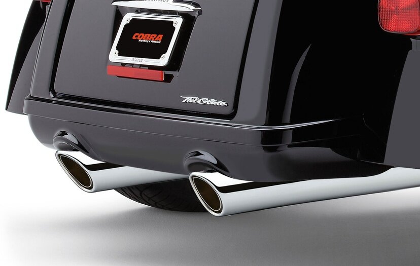

    I have 4" diameter Cobra 909-Twins Dual Slip-On Exhaust. I do have to exercise care when going up steep inclines or turning into driveways with a large drop off. Otherwise, I have no problems due to their size. Should get some relief after I install my DK Convertible Comfort Lift Kit.
    If you would, please tell me about your Cobra set up (A/C, tune, cat or no). I am still on the fence on that.

    They're Cobra's 909-Twins Dual Slip-On Mufflers, sku: 6303 . No engine mods, stock A/C and no tune. I chose these because they're not excessively loud at highway speeds and I can even hear my music at reasonable volume. I'm considering DK's 606 setup in the future to use with my stock cover, but haven't checked to find out if a tune is required if used with the Cobra 909 Slip-on's. Already have several parts for lift, lighting and comfort on my kitchen counter waiting for better weather to install. Here's an image.....

    Jeff, I describe them as having a throaty but pleasant sound through the gears and no overpowering or annoying noise at interstate/highway speeds. I really can't make an fair comparison with the stock mufflers, because I only rode 45 miles from dealer to home with the stock exhaust, then changed to the Cobra Slip-ons before the next ride.
    Yea, I kinda figured I'll need a tune with that A/C and the Cobra slip-ons. That and the addition of a tuner is why I've made no inquiries on moving in that direction at this point. Pretty sure I'll also want to have some changes made to improve exhaust cooling, along with adding Love Jugs. Just have to get my current to-do list installed, before moving to the more costly and involved changes.

    I am running Cobra 909s, de-catted stock head pipe and the DK 606 air cleaner with stock cover and external breather system with a Power Vision tuner on my 2015 Freewheeler. I am very happy with the sound of the Cobras and the performance of the bike. The Cobras sound good , very throaty under acceleration and run down but not excessively loud at highway speed. I also have the Love Jug Mighty Mites and run them all the time. They do a good job of cooling the engine down some. I also have a DK tank lift kit to let a little more air circulate around the heads. I am very pleased with this set-up.
