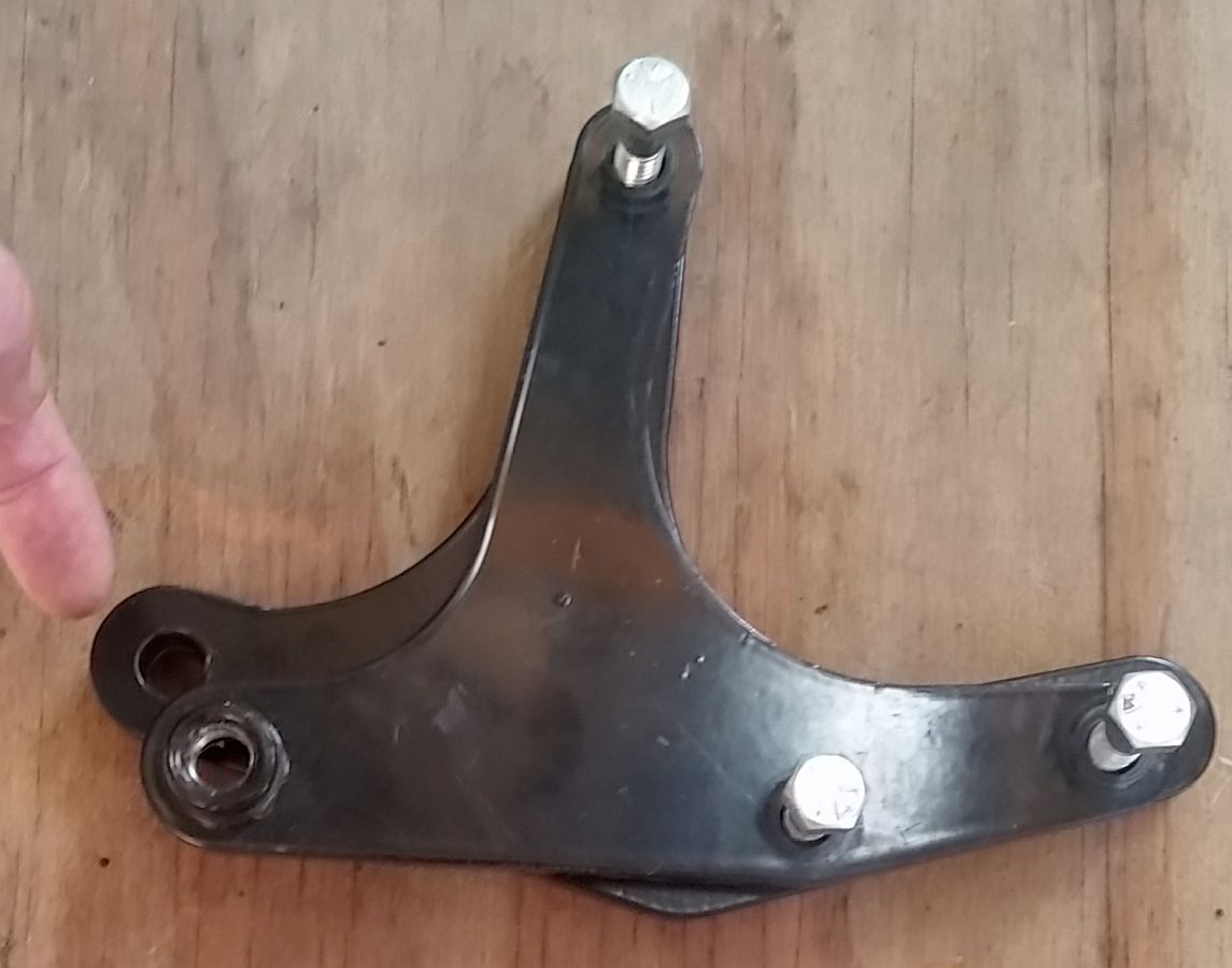

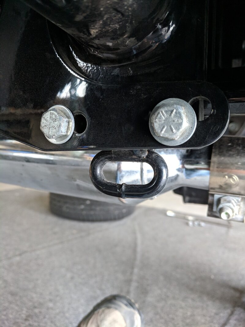

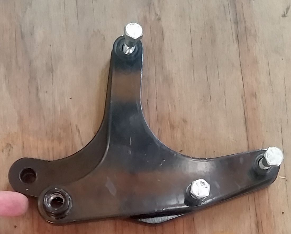

    To answer your second to last question first-
    The 14" Convertible Comfort Lift™ is more about Comfort than Lift. (This is very different than the "normal" Convertible Comfort Lift™ that is made for the factory 13" shocks)
    The lift for the 14" shocks has two sets of holes. Full Lift and Secondary Lift. BOTH sets of holes put the shocks in a more cantilevered position, which helps the shocks operate smoother (better comfort).
    The full lift position, when combined with the 1" longer shocks, raised the body, at the axle, 1.25". So the net increase is 1" from the shocks and .25" from the lift. But when you look at it in the photos below, it looks like more than that, because it puts the shocks at more of an angle.
    The secondary lift position, when combined with the 1" longer shocks, raised the body, at the axle, 7/8". So the net increase is 1" from the shocks and minus .0125" from the lift. But when you look at it in the photos below, it looks like it is still raising the body, but that increase height of the bottom shock mount is being eaten up by the shocks being at more of an angle.
    Answering your first and last questions-

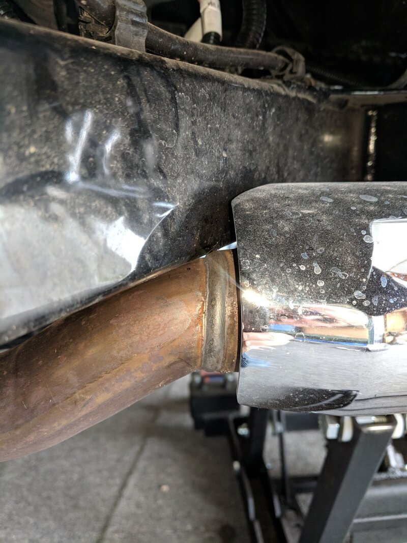

    If you are curious, or if you are scraping your mufflers, then it may be worth it to you to take a second look.
    There are usually only two things that can keep your swing arm from dropping all the way down-
    The very front of the swingarm touching the S-shaped adapter going from the headers to the mufflers
    Or, some part of the jack or jack stands preventing the swing arm from dropping lower.
    The difference in height between the full and secondary is 3/8", not much. The difference in comfort is even less. They both put the shocks at a better angle for improved comfort.
    This first photo shows the 14" Convertible Comfort Lift™ on the bottom, and the factory bracket on top. It is set at the Secondary position, and you can see that there is a significant difference in the location of the bottom shock mounting hole. This is what changes the angle of the shock and improves the ride quality.
    This second photo shows the 14" Convertible Comfort Lift™ on the bottom, and the factory bracket on top. It is set at the full lift position, and you can see that there is even more difference in the location of the bottom shock mounting hole. This is what changes the angle of the shock and improves the ride quality, as well as lifting it 3/8" more than the secondary position.
    Hope that helps.
    www.DKCustom.com
    My brackets installed using the standard lift holes.
    Here's the swingarm barely touching the exhaust weld.
    Nice weld on yours...some of them really stick out much more.
    Good to read you're enjoying the improved ride quality.
