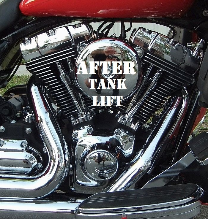

    Sure enough, there are extra wires and hoses showing
    Extra chrome too
    As far as looks, everyone has their own tastes.
    Regardless of looks, primarily I do it to get the extra cooling.
