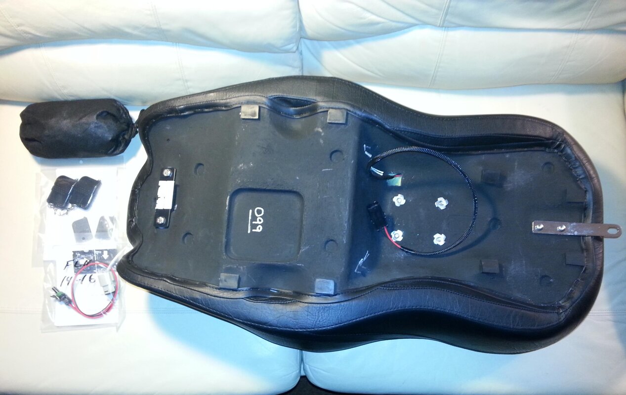

    Name:  Ultimate Seat's - Tall Boy Seat.jpg
