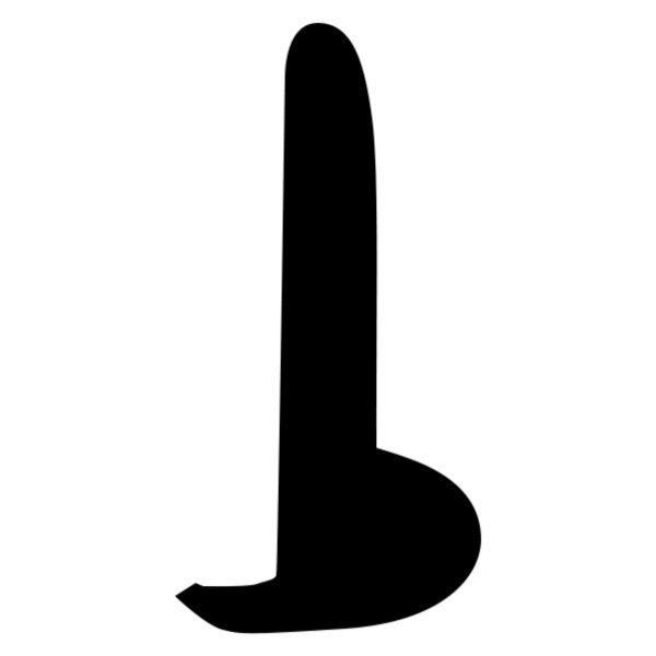

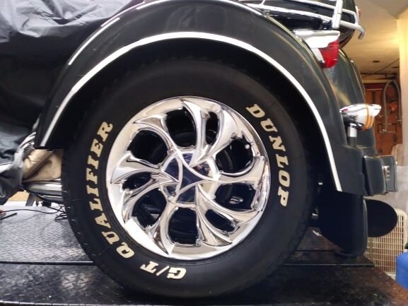

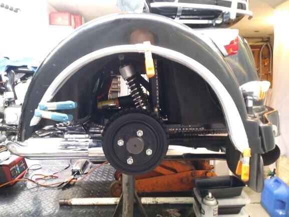

    Well I tried on the Kuryakyn 7214 Side Flairs using some spring clamps and I found that they do not fit my 2002 Lehman Predator Trike. If you look at the picture, the front piece (left side) is about 2" short and the rear piece starting at the center keystone, is not centered with the wheel (brake drum), it's off to the right (rear) by 3/4". At the center keystone where both pieces are to meet, I have about 3/8" overlap, maximum overlap is 1". The rear piece can be modified to fit better, but the front piece needs to be 2-1/2" longer. The 2 pieces are close to matching the curve of the fender.
    As far as the cost of $127.00 is way to much for what you get. The cost should be about $75.00 for the 4 pieces. I am returning the Kury 7214 fender flairs to Amazon do to not fitting.

    I thought they were to short for my liking and you could mod the rear piece by cutting off the under lip about 2" long and rotate it forward a little.
    I traced the left side on paper, both pieces, as shown in the picture. If you want I will send it to you by mail and you can see the 2 parts and you could even cut them out to see how they would fit. Send your mailing address to deleted (my spam address) and I will put it in the US mail.
