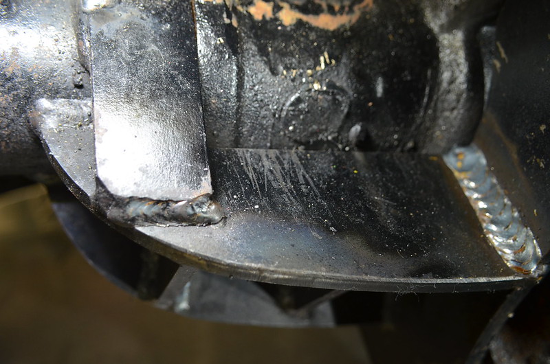

    With a small box of shiny stuff too!

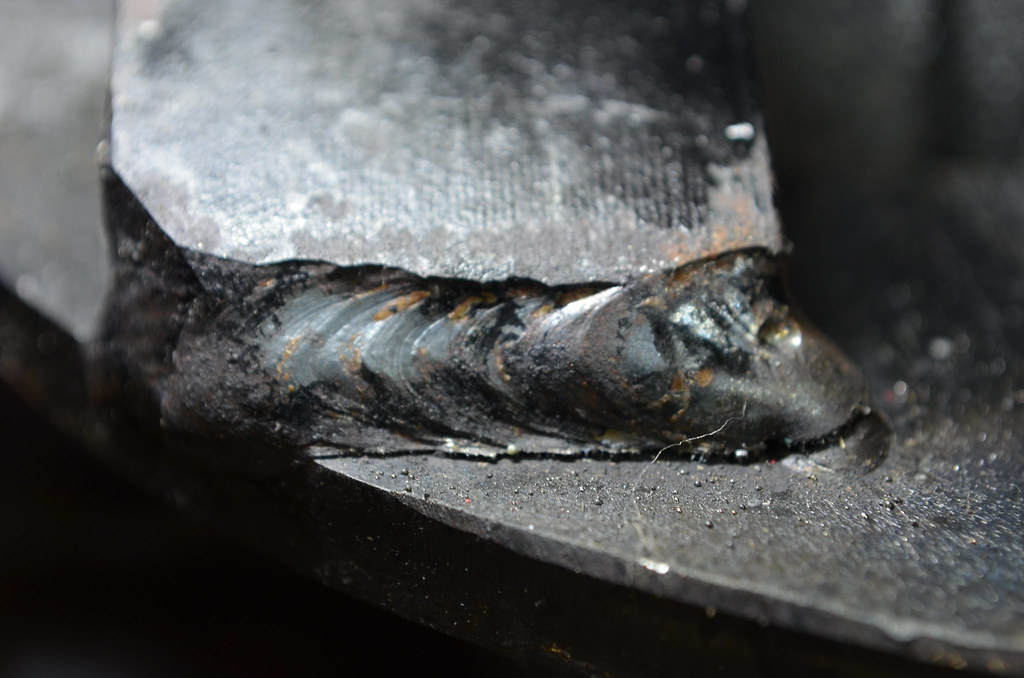

    Unfortunately, this crack came home too.
    REALLY?!?!?
    Not like I POSTED F"N PICTURES IN HD OF EVERY SINGLE CRACK.....................
    (above picture is before it left. I am not in the mood to switch my camera lens, set up the light etc for one pic)

    Delivery man dropped it?
    Makes you wonder how deep the welds are? Stresses built up?
    I know you're going over welds with magnifier & bright light, I would be. If that was the only one cracked, I might would Vee it & put some of my own melted metal on top.
    Is that rust I see? Any chance that's a cracked weld from before?
    Cracks in welds ain't horse shoes ... close don't count.

    Delivery man could have tossed that crate off a truck, it would have done lots of crate damage before ever getting close to affecting the contents.
    The rust was there when I sent it. The picture is from BEFORE I sent the axle out. Evidently they didnt bother to check the axle thoroughly.
    Its not like I provided a full color high definition collection of pictures showing the cracks. Wait..... I DID.
    And Richard made it clear they were aware of this thread.
    Not to mention they doubled up on the welds for the spring shocks and airbags. FOR NO GOOD REASON I can see but to run beads. I am sincerely hoping they didnt warp the axle tubes. Whoever was welding got penetration all right....
    There is some serious weld warping on the ladder bar bracket. The welds look great, but a lesson in weld sequence and weldment warpage might be in order.
    Here is a simplified expanation of what I am referring to.
    http://www.weldingtipsandtricks.com/...istortion.html
    ""The accumulation of weld metal shrinkage stress from a weld bead can be compared to boot laces.When you lace a boot each lace holds a bit of stress.
    And if you ignore that fact, you can wind up with boots that are laced too tight at the ankle.
    Each ripple of a weld bead is a freeze line and indicates a solidifaction of weld metal that shrinks upon cooling. All that shrinking adds up and that is why the direction of travel of a weld bead has a great affect on distortion.""
    So... once I cool down a bit, a proper inspection of the axle will take place. See how welds were put down, start using a straight edge to see how much things are distorted.
    Try to get a feel for how much locked in stress there might be.
    Check and see if the axle ends are still pointed towards the center of the differential. All those *$#*@#$ UNNECESSARY beads on one side of the tube, and possibly put down with no regard to warpage.
    See if I am going to have to anneal the entire axle, and if that is even practical.
    I am just in a bit of shock. After feeling so good about the service, to have such ....well... 'product' sent to my door..
    I would be very hesitant to trust their work without intense inspection. SO glad I spec'd no paint on the axle. Thick coat of black paint would have hidden things. I would advise anyone getting a weldment to request NO PAINT.
    Returning it with the same crack(s?) it left with... Damn. Thats sad.
    I sent these guys my best. If this is their best... there is plenty of room for improvement. Next time charge me more and do the job completely.
    Sorry for the rant. I have to get back into 'work mode' and attend to this later.

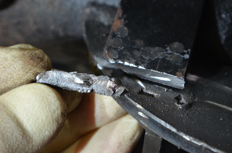

    Quote Originally Posted by Jack Klarich View Post
    That really sucks. Shouldn't that crack been ground down before welding? Shame on the welder
    Little misunderstanding here... the cracked weld you see was on the axle when I sent it to them. Welder missed it....
    I will be welding it, and HELL YES it will be 'Vee'd' out before welding.
