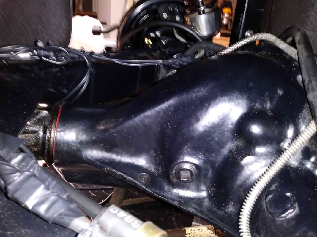

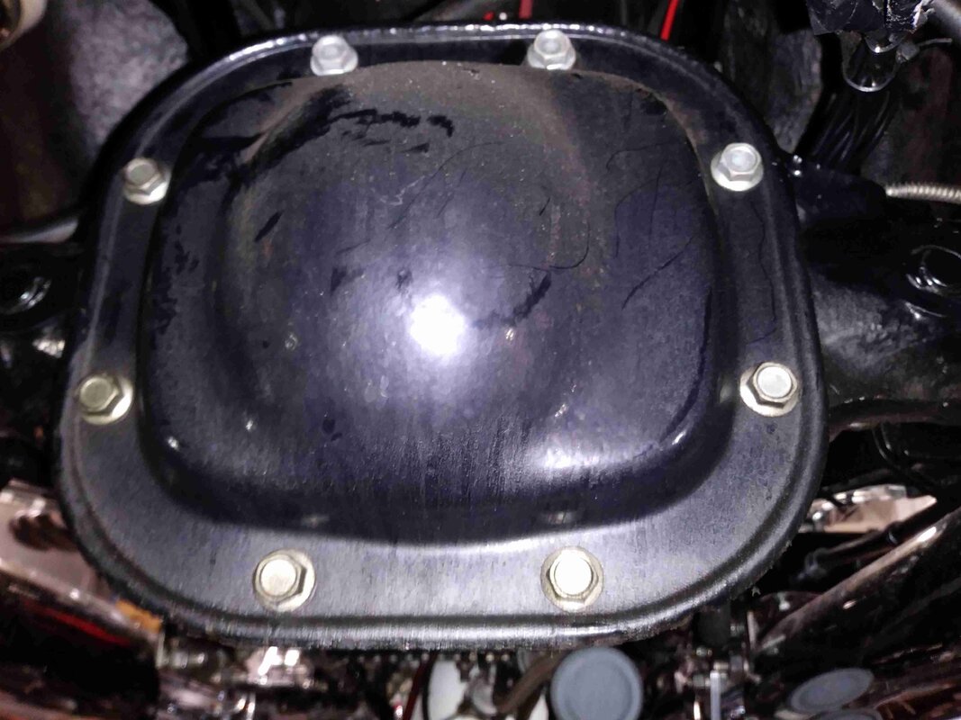

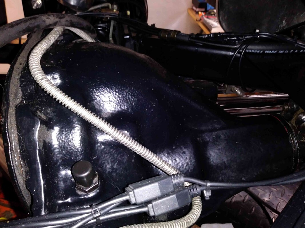

    Hi Jim,
    I have attached a picture of the rear cover and both sides. Hope the pictures helps.
    Sorry for the large pictures, I thought they would be thumbnail size.
    Greg

    I have been reading posts for a few hours trying to do some self-help. I found 2 (.pdf's) that look like the information that I was asking about.
    Diff Parts Diagram.pdf and Drum brake part info.pdf
    Are the 2 documents (pdf) correct for the pictures that I have in my last post? For a 2002 solid axle with drum brakes?
    Would you recommend different parts or are these parts good replacements?
    1 last question, to change out the final gear lube, how many quarts do I need?
    Thank you for all the knowledge you provide and time that you expend answering questions where information is so hard to obtain.
    Greg

    Greg,
    Some of the parts are the same.
    Obviously the rear differential cover gasket is not and the internals are also different.
    The axles may be 25 spline and they would be different too.
    When adding oil to the rear, fill below the plug (3/4").
    Jim

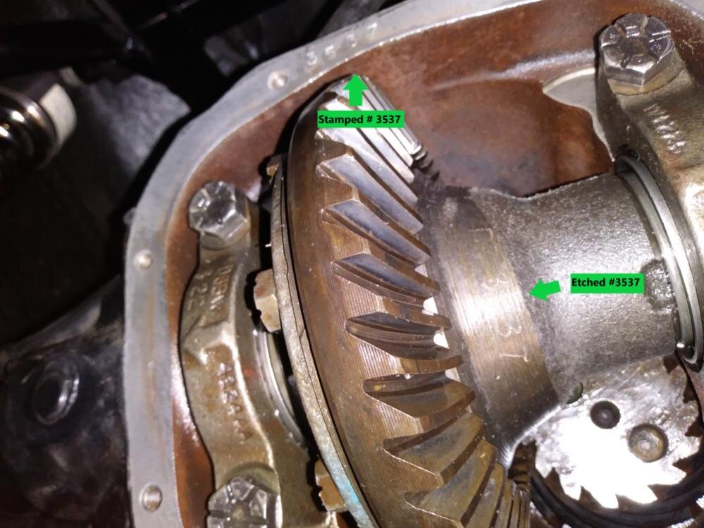

    Jim,
    When I was cleaning inside the differential I found stamped # 3537 at the top of the differential case. On the ring gear the # 3537 was etched into the gear. See picture for locations. Do these numbers cross reference to any information about the rear end? Could Lehman supply any information using this differential number (3537) or axle kit # YS-0200767 ?
    Thank you, Greg

    The ring gear has a series of numbers and letters.
    Count the ring gear and pinion teeth.
    Any casting numbers and where they were located.
    See if you can send me all of the numbers in their particular groups and I will try to find out what those numbers tell me.
    Jim

    Jim,
    The numbers (3537) were hand punched into the top of the differential casing where the gasket goes and also engraved with a vibra tool into the ring gear spacer as marked in the attached picture.
    Ring gear is factory marked (D97W 4210-BA-1541) I will count the teeth on the ring and pinion before I close it up.
    Greg

    Greg,
    The D97W-4210-BA is really D9ZW-4210-BA and comes back as a ring gear, part of a ring & pinion set.
    D7FZ-4209-A is the ring & pinion set number and fits a 77-78 Pinto, Mustang with a 6 3/4" rear axle.
    The ratio for that set is 2.73:1 (15 pinion 41 ring).
    Problem or issue ???
    The 77-78 Pinto, Mustang had an octagonal rear cover and yours is square (1979).
    Your picture shows 79 type bearing shims instead of a 78 and earlier threaded case pre-load adjuster.
    See if you can look on either side of the carrier for a casting number.

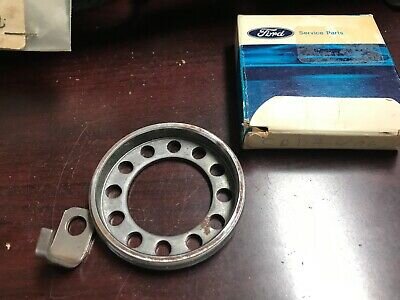

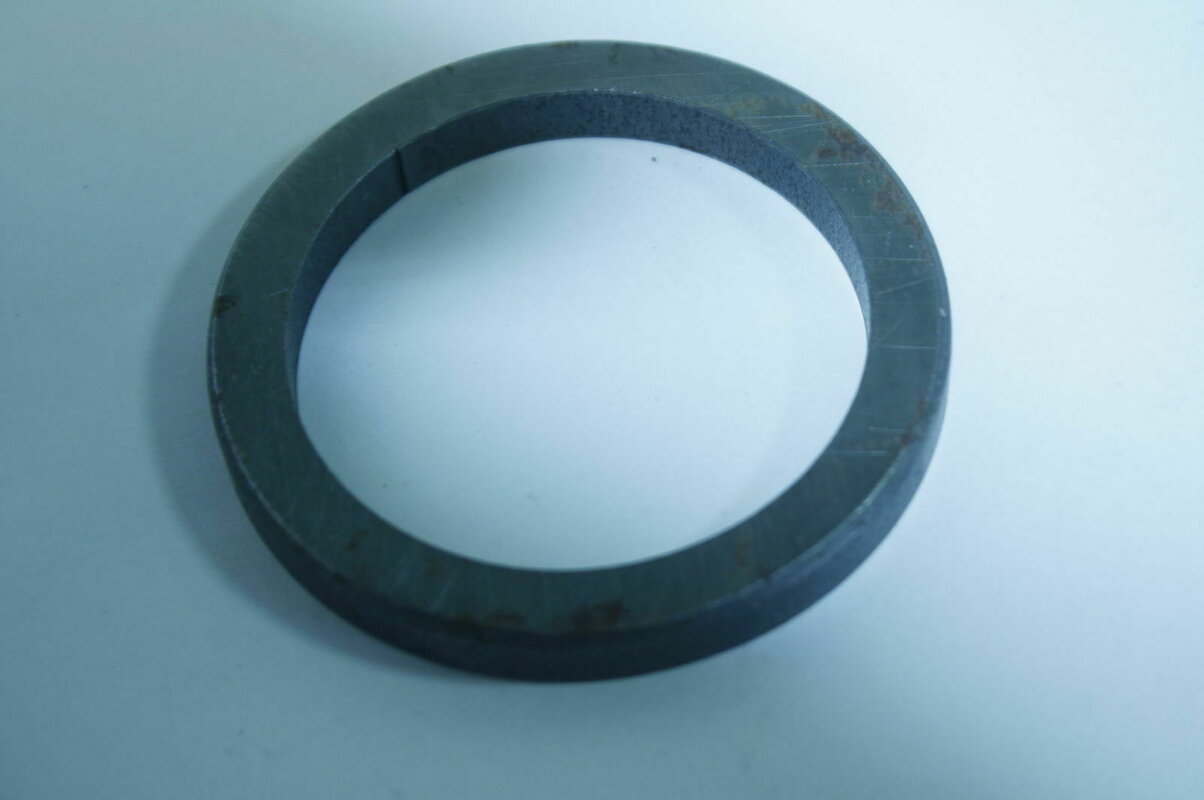

    The pre-load shims are much thicker.
    Name:  6.75 diff early.jpg
    77-78 6.75" housing with adjustable carrier pre-load and locks.
    Name:  6.75 C0DZ-4067-A.jpg
    The actual adjuster and lock.
    Name:  6.75 ford carrier shim.jpg
    The pre-load shim used in the 79.
    Jim Murphy

    I could see the shims in the pic, I just couldn't measure them.
    It was just a thought.

    Jim,
    I counted the teeth on the ring gear (total 41) and pinion gear (total 15) teeth.
    Ok, the ring gear markings are D9ZW-4210-BA. The Z looks like a 7, poor incomplete punch mark.
    Yes, the differential cover is square in shape, not octagonal.
    I looked at the markings on the part to the left of the ring gear and it had D9BW BA and a #10 with what looked like (GB in a circle).
    The part to the right of the ring gear was marked 9E23 and had 7 razed dots in the casting.
    I'm not having any problems, all parts have very little play, if any, when turning by hand. I was just looking for information about my Lehman kit and replacement ware parts (seals, bearings and brake parts) just in case a problem does happen. I hope I never have to disassemble the rear drive other than changing the differential oil.
    Thanks, Greg
