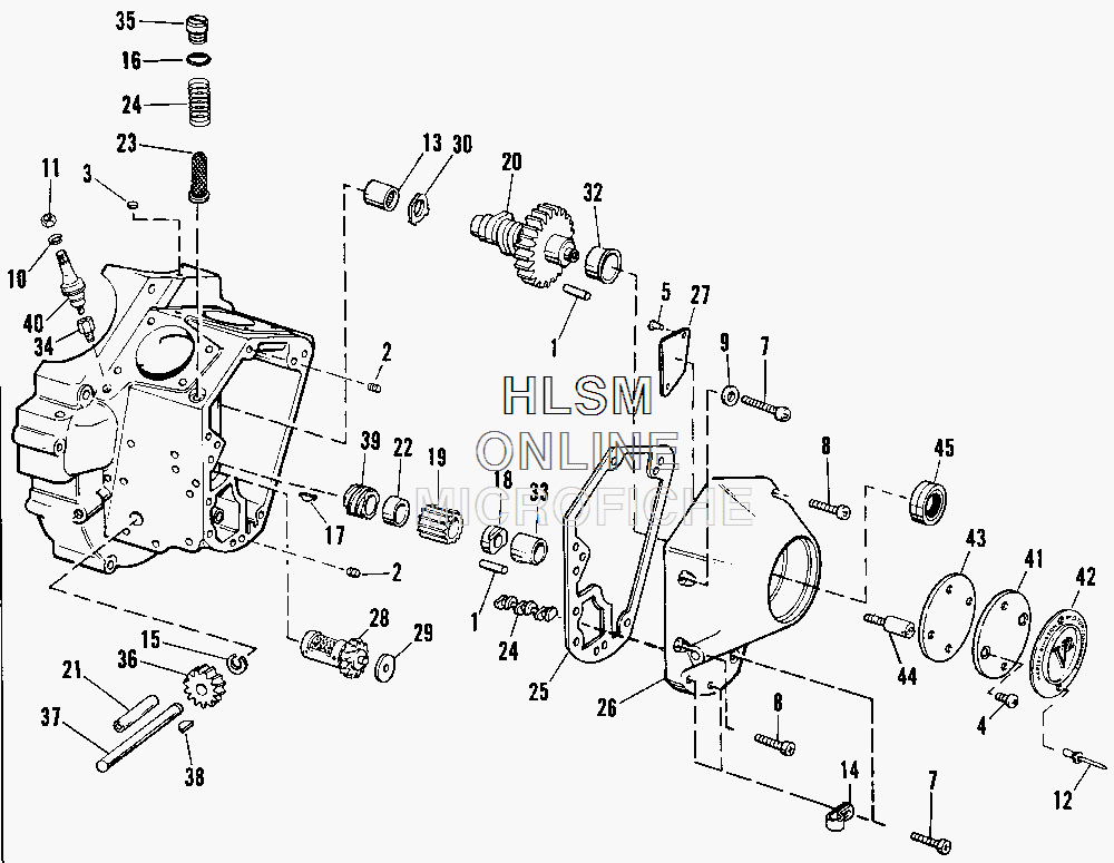

    5 years ago HD had a EVO crate motor exchange program . The new motor came with vented heads like the twin cams . Reciently it started sucking the primary oil into the crank case creating oil overfill and puking from the motor out of every motor vent area possable.
    After checking the primary seal to motor , all was fine visibly.
    Talked to many HD techs and it is not an issue . Any one else had this problem ?

    Did the breather gear break.

    Quote Originally Posted by Mykneesbehurtin View Post
    Didn’t know it has one mainly blows oil out at 55+ mph. Gota check the book for location.

    Quote Originally Posted by 1dn5up View Post
    #28 is an Evo Breather Hope you don't have a cracked inner primary
    The factory gear is plastic,it has a timing mark on it.If it is out of time this can cause problems.
    The cheap plastic would also get deformed and cause scoring in the cavity it rides in. This caused major problems on lots of engines. I changed mine to an S&S steel with a modified screen for improved scavenging
    Still looking , so far, can’t find anything ........ the investigation continues......
    Pull the cone cover and verify timing marks are ALL lined up. 1 tooth off on breather gear could cause a huge problem
