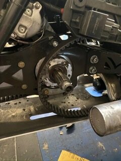

    I led a 350 mile ride two months ago, and was almost home when I downshifted into a turn and tried to accelerate, but only crawled. Thought the clutch was gone, so I replaced with all new Barnett set, plus pressure plate and spring. Guess what? Same behavior as before. Ended up taking it back to the shop that did the conversion and was told there was a problem with the jack shaft and maybe more. Hopefully, it’ll be fixed before fall riding weather returns to AZ.

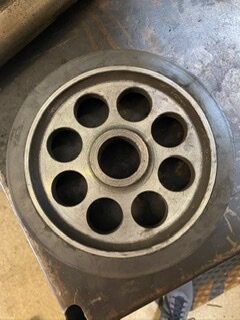

Size:  33.6 KBName:  D61A41DE-BC57-4189-A83A-FDDAA30C41CB.jpeg
    The jack shaft pulley was improperly heat treated and the inner splines stripped out. Waiting for new parts, now.

    Wow! A defective part. Were there any early signs of the problem that you noticed?

    Quote Originally Posted by Ben_D View Post
    That happened to quite a few Can-Am Spyder's early on.[08/09]....Factory Specs were Way too tight for the drive belt....

    Quote Originally Posted by Iowavicrider View Post
    None whatsoever. I was nearing home after a 350 mile ride, downshifted into a turn, and when I tried to accelerate, the engine revved, but I couldn’t go more than 5mph. I felt sure it was the clutch.
    Thats the way it was with my Spyder [08]...Made a left turn out of a light shifted into 2Th. and the engine just revved...Thought it was the cluch also...

    Ben, has the new one been tested for hardness, it could be the same as the original.

    Quote Originally Posted by Alansut View Post
    Well, I sure hope so! I’m waiting for the new sprocket to arrive from the factory. If it happens again, I will be very pissed!

    UPDATE! My trike and I are back on the road! Thank you CSC for the prompt shipping of my sprocket and retaining hardware! Also, thanks to Dave Bierman of Southwest Trike Center!
