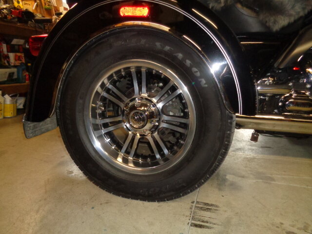

    I switched rear tires at 31,520 dry rotted in the tread face dunflop OEM . Front Michelin front I have over 15,000 now with 5/32" tread left. This most likely last season for it.

    Nice to see someone else went to higher tires and like the improved ride and handling. I wasn't sure there was room for the wider profile but eventually there is good to hear. Have you noticed any better handling the 70's really helped my handling a great deal.

    started out with 26 pds of air ended up at 22 , yes it handles a lot better , looks good with the big tires , its like a different machine . thanks for the great Idea .

    Nice to get a little more weight on the front wheel what a difference it makes. Our 09' was in need of maintenance so I upgraded springs and valves from Pro Action. These sure ended the nose dives, but we are working to eliminate the occasional noise from the springs or valves for some reason. Congratulations glad you went with taller tires. There is room for 75 series but you would need more power than my stock 103 has. Ride safe Fred
