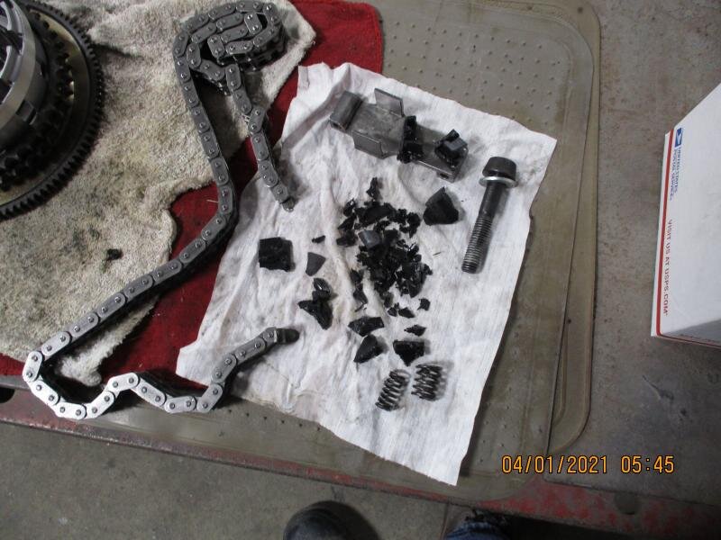

    Went for a ride the other day stop at red light light turns green turn the throttle trike stalls , wont start push it off the road hit the starter button just hear a loud thud put it in gear rock it back and forth motors locked up What the F___ ?
    Call my brother he comes get me let it sit for a few days, take it apart long long story , short of it the hayden primary chain adjuster broke went in to the primary chain and clutch hub sprocket pulled the primary chain half over the gear had to cut the primary to get it off , well I wish that was it. broke the clutch hub and bent the crankshaft the crank is 70 thousands out , and it f--- the engine case . It would of been a good day to start Drinkin again ? what ever ordered a new short block & many other parts $ 4000. so for . Hayden will not return a phone call text or email ?

    Default picture of Hayden
    Picture of what's left of the Hayden primary adjuster . I have used 20 hayden adjusters with the white shoe never a problem with any of them . The m8 shoe is made of this cheep lookin black dog poop , Hayden will not return phone call's ,email's or text. fix and go on

    Quote Originally Posted by ROAD DOG View Post
Size:  74.5 KB Picture of what's left of the Hayden primary adjuster . I have used 20 hayden adjusters with the white shoe never a problem with any of them . The m8 shoe is made of this cheep lookin black dog poop , Hayden will not return phone call's ,email's or text. fix and go on
    I cut the chain to get it off , It did not break

    Quote Originally Posted by Bush Hog View Post
    Ordered A Hayden primary chain tensioner for my ride not to long ago. After opening the box and and inspecting the product, I decided to reinstall the factory tensioner. It just didn't look well made to me.
    They used to be great now they are shit . Plus no service at all ?

    They were good on the twin cams , Hayden must have change the shoe material for the M8 theres a lot of bad reviews on Amazon , I guess they can't remove them from there, they claim that they dont sell on Amazon that those are counterfeit somebody posted a picture of one from Amazon it's stamped right on it Hayden? They dont answer there phone so they cant be selling much? I will have my sister try to call from florida see if they answer
