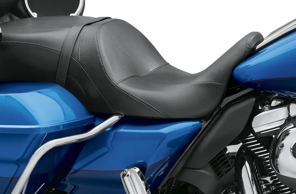

    I did see that Harley does make a couple of seats that fit the Freewheeler and come with the strap. Don't know if it's worth spending $400 for seat to get a strap, but somebody may have a dealers parts book that may list it as a repair/replace item.

    Quote Originally Posted by JTJersey View Post
    Name:  Screenshot at 2022-03-14 19-18-08.png
    Yeah JT, I dunno about that, what I know is bagger seats will fit a Freewheeler, BUT the bagger seats that use a passenger grab strap attach to the side plates on the fender of a bagger via a docking set up. I have a Roadking seat on my Freewheeler, there is no provision for a grab strap, nothing on the seat pan to attach it to See # 20 here, you will not see it in your picture in your post, it is covered up by the saddle bag lid

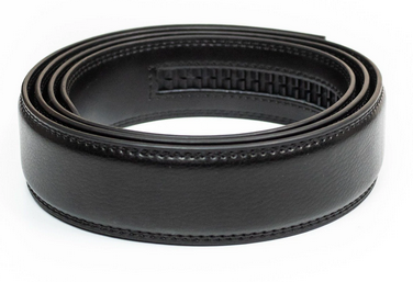

    How bout a thick black mens belt..AKA; Garrison belt..?

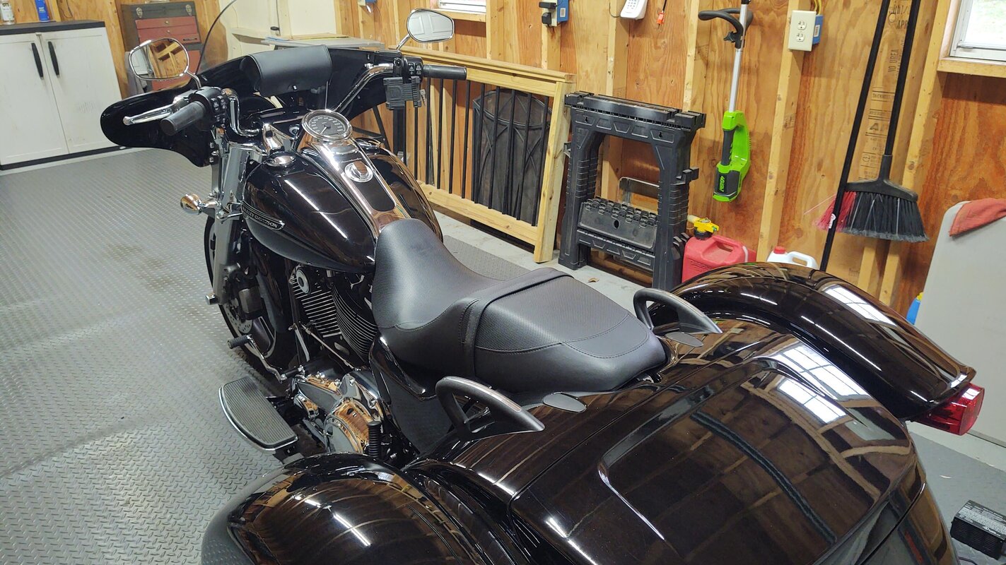

    Still too cold to ride so I went out in the garage and grabbed an old belt.
    With the stock seat, you'll need a least 24 inches of strap (start long, trim to fit later). Use the mounting points under the seat (yellow circles where Grasshopper backrest receiver is mounted).
    It should position the grab strap like this, just behind the slot for the rider backrest.
    That is a 1.5" leather belt in my example. One inch would be perfect. You could probably find a good leather, sacrificial belt in a thrift store for just a few bucks.

    So I found these guys: https://dmleatherstudio.com/collecti...her-strap-belt and went ahead and ordered the 1" x 39" black leather strap for $11 and change.

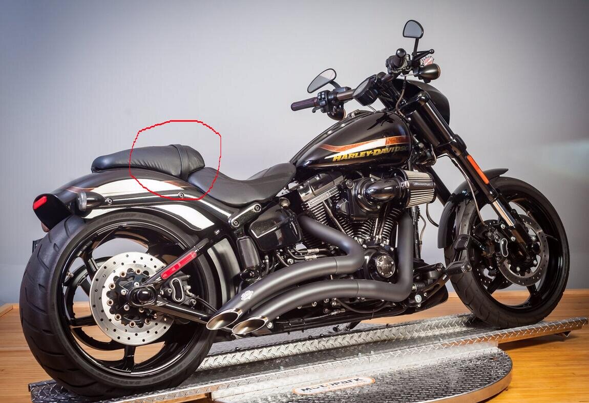

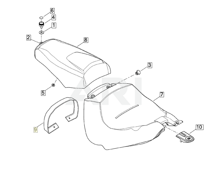

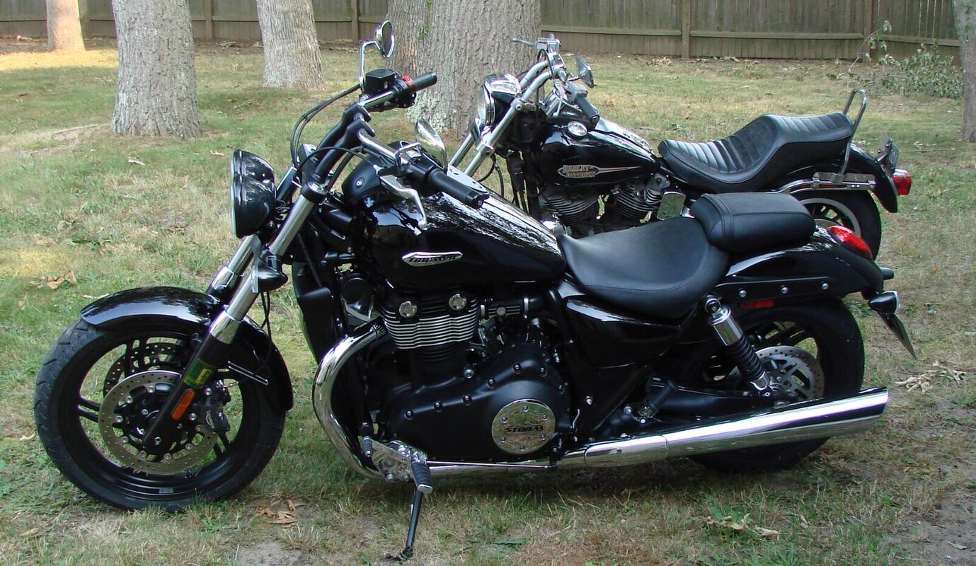

    Apparently the FXE Breakout had a strap just like my Triumph Speedmaster. Looks like it attaches underneath the seat pan, or could. They don't give any specs on it for length, but if the black leather strap I ordered doesn't look right I might try that next. I can return it if it's a no go.
    Name:  Screenshot at 2022-03-17 12-48-02.jpg
Size:  139.3 KB Name:  Screenshot at 2022-03-17 12-47-35.png
    You might try these type nuts on the seat pan, cut a slot slide it in and drill a hole

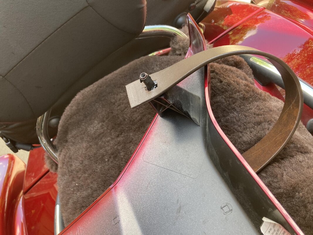

    Found this on eBay for $11 and $4 shipping. It's 29 1/4" long, plenty to work with. It's apparently for an '82 an up XL according to the HD instruction sheet that came with it. I positioned it and taped it to seat bottom for planning. There's plenty of thick plastic in that area and should have no problem getting a solid mounting. This is doable, but I'm in no rush to do anything right now.
  20. #20
    750+ Posts
    Gold Club Member
    JTJersey's Avatar
    Jul 2021
    Millville NJ USA
    798
    Default

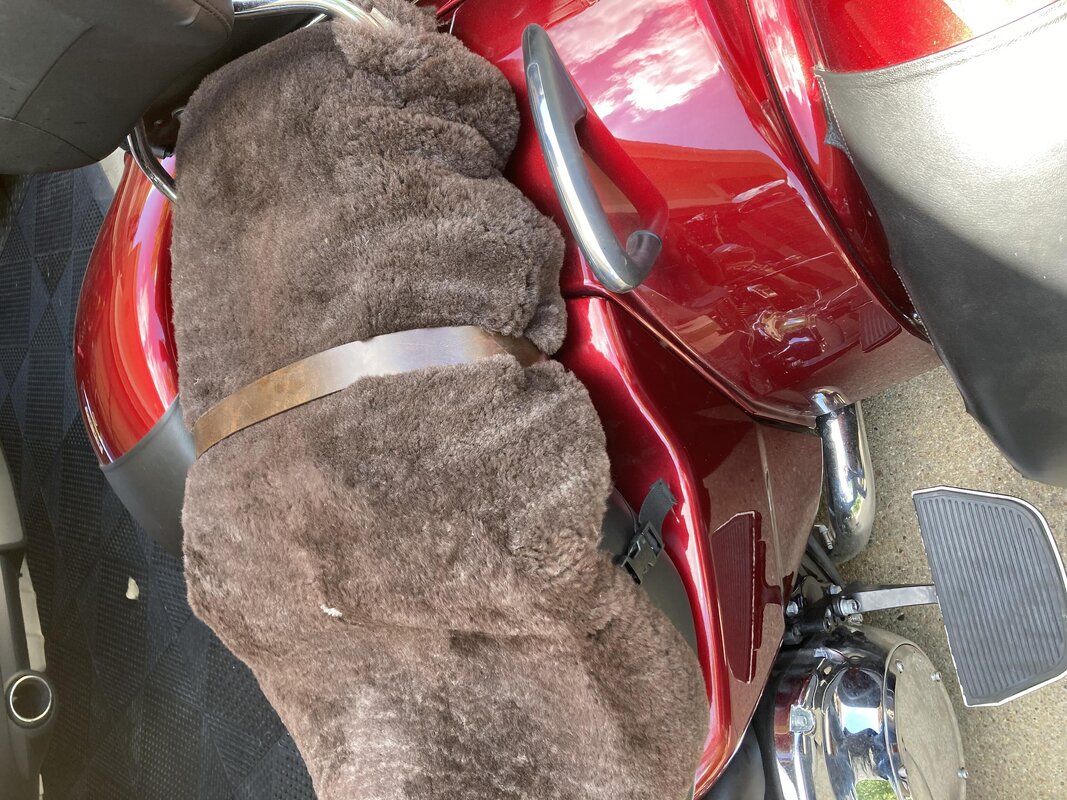

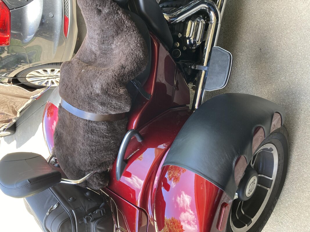

    Finally had some weather where I wasn't freezing my hands off in my garage and screwed the Sportster strap I got to the seat pan. All good. Looks like the pics I posted previously so no sense in posting again. The idea being to remove the grab handles. Took off the right side grab handle first and was dissapointed to find the back part of the handle had imprinted itself into the paint and no amount of polishing was going to remove it. Not going to repaint the bike for this project so I put it back on. Oh well. Not that big a deal. Left the strap on for the time being. Doesn't look out of place so no need to do anything about it right now. It was still fun wrenching on the bike even if it wasn't productive.
