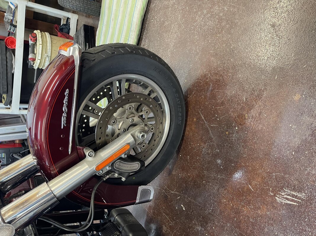

    I just put on a Shinko Super Classic 270 tire and love it.

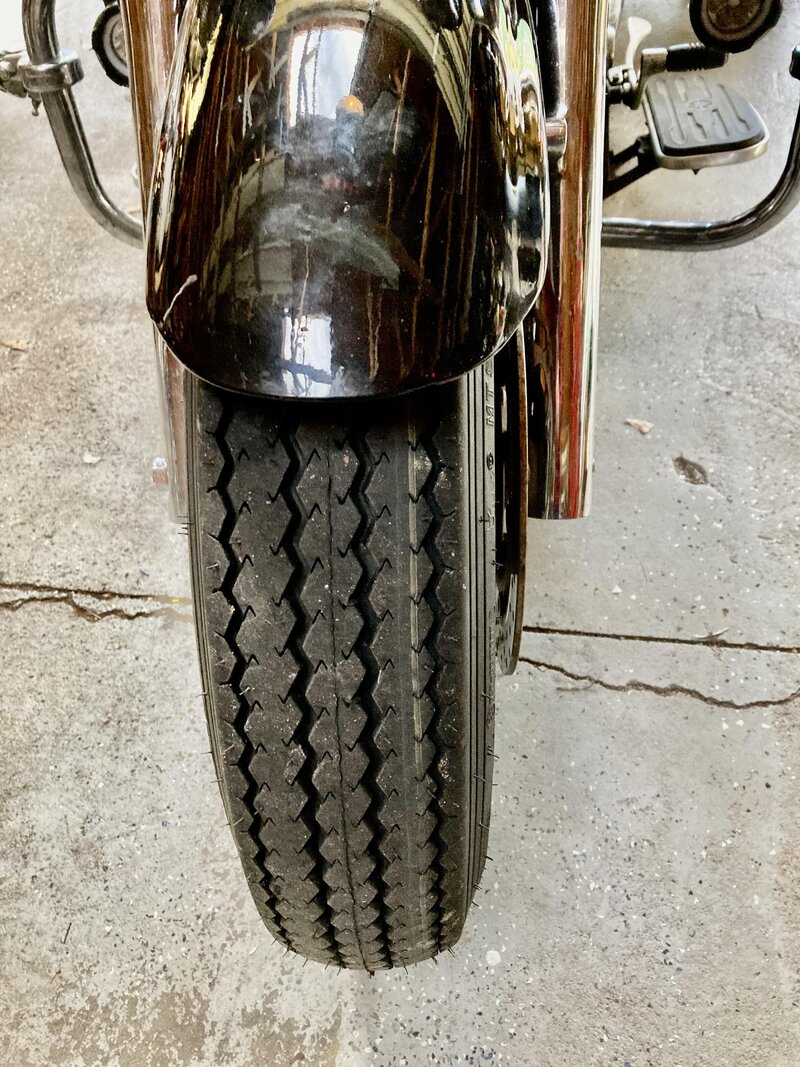

    My trike came with a Michelin Pilot Active rear running backwards on the front when I purchased it. Mileage on the tire was unknown but I put 18,000 miles on it. My dealer, who I trust, said they have had problems with cupping on that tire. Mine was pretty well cupped when I bought it but the cupping seemed to smooth out a little as it got worn down.
    I was inclined to replace with an Avon trike specific front tire but they are not available at this time. My dealer strongly recommended a Michelin Commander 111. Dealer is a trike dealer and manufacturer (Champion of Arizona) so I went with their suggestion. So far so good. The bike feels a little more cushy. I think the MPA rear on the front was stiffer and gave a harsher ride. Time will tell as far as longevity..... Jim
