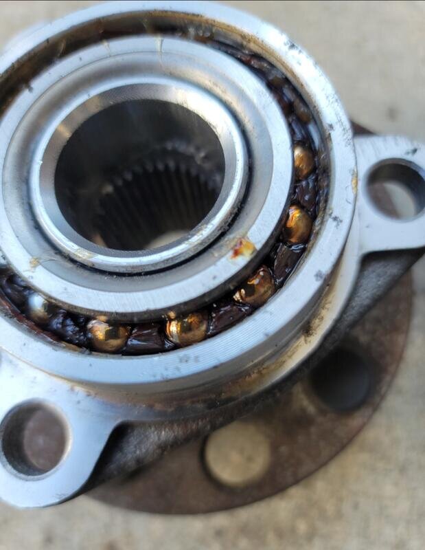

    Just went through this with my 2019 Honda/CSC at 8100 miles. No wobble but horrible noise and vibration, left side hub bearing unit failed. I appears to have been assembled with no lube went new. This is NOT a CSC problem since they just source them (standard auto part item)

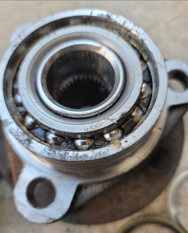

    Here's Carquest, Genden, Advance auto parts bearing number 91-45065 I think Cavalier front non ABS is the same all years. Check out the picture of these versus the other brands . I don't know why the right rear wheel bearing in these burn up 6 - 8000 miles for what there is for weight on that wheel compared to a car ????? I pulled the dust shield off the new ones to be sure they had grease in them, they were good, I also check the bearing on the new differential to be sure there was grease.

    All done. I was able to track down the original wheel bearing hub by the part number and it was a Moog hub for a 97 Chevy Cavalier. CSC sells them for $70, Rock Auto cost me $35. I'm assuming the rotor is probably for the same vehicle?
