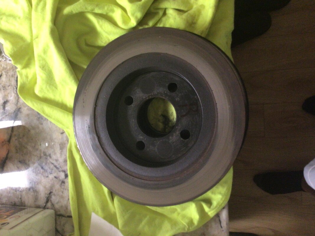

    Well I found my shake. My right rear rotor is obviously warped, you can see the warp. I’m gonna see if my tire shop will turn it for me.

    Good luck with that, I have machined a lot of rotors and flywheels
    The down side is trying to match the run out you have with the lathe is the fly in the ointment
    Solid rotors do not machine very good to begin with, let alone not knowing the run out on the hub, that said make sure you know the minimum thickness before machining
    One last thing, did you match mark the rotor to the hub before you removed the rotor?
    This can contribute to even more run out when you put it back on the hub if you did not match mark or ( index ) it

    I did not. Index them,I guess I will just wing it. I have a feeling I will be buying a new rotor. The other one looks even.
    They only have 5000 miles on them, I’m gonna take a chance.

    If u have access to a dial indicator you could put the rotor back on with 2 lug nuts opposite
    from each other, do a sweep and record your reading, if .003 you should be OK, if not you can index the rotor 180 degrees and try again, 50 50 chance of better run out, we used to always do a run out and re index before machining, sometimes it was a big win for the customer

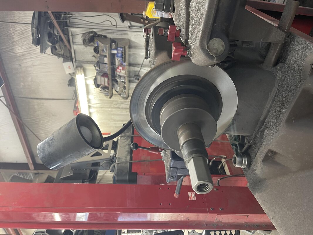

    I had a set of rotors turned on my buddies 09, I was standing with the guy when he turned them. They came out flat and parallel but the finish was a little rough, when he was turning them it reminded me of machining stainless steel, just kind of gummy didnt give a good finish.

    $10 a rotor, both turned a we shall see. That’s all I can say.

    Not a polished finish

    Wash it off with soapy water before install, lots of water

    I cleaned it up with brake cleaner. Took it for a ride. Brakes needs to be seared more, I will give it a good ride tomorrow. Too hot n humid today. Had to clean the pool and Now I’m spent.
