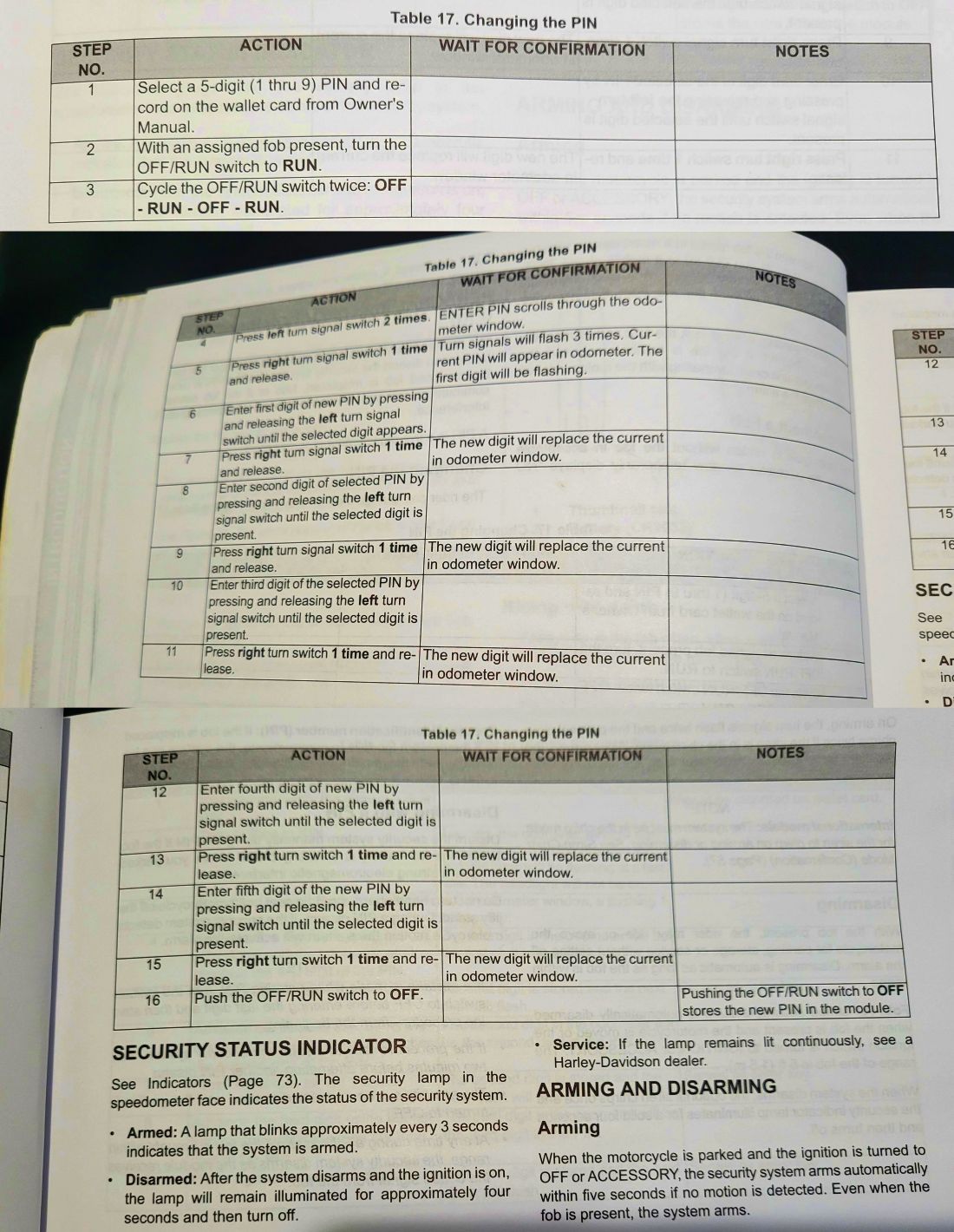

    Question How to reprogram PIN?
    How do you reprogram (change) PIN?

    Your security system must recognize the FOB in order to view or change the PIN.
  21. #19
    Sponsor
    TrikeTalk Sponsor
    DK Custom Products's Avatar
    Jun 2013
    Red Banks, MS
    9,131
    Default
    Quote Originally Posted by Amputee55 View Post
    We did not cover that in this video. It is in your manual...you don't need the big manual that is now costing over $100...it is in the little manual that comes with the bike.
    Harley has changed the procedure a few times over the years, and it can be different for different model bikes, so look in your manual, you will find it.
    Here is a photo of how to change the pin, from the little manual, that came with my 2019 Tri Glide. It can be different for different years and models.
    Quote Originally Posted by Mykneesbehurtin View Post
    My 17 won't show me the pin by doing this. I tried it with the key in the ignition position and the accessory position and nothing. With the kill switch in the off position I turn the ignition, turn the kill switch to run. Then cycle the kill switch twice, then cycle the left turn signal twice then press the right once. Nope nada, just the mileage shows up. ???
    Two things:
    1. Sometimes you need to push the buttons faster to get it to work...leaving too long of a time between pushing the next button will not work.
    2. Harley has changed the procedure a few times over the years, and it can be different for different model bikes, so look in your manual, you will find it.
    www.DKCustom.com
