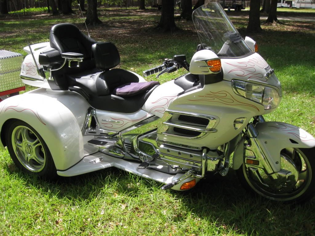

    Here's the best modification I made on our 2010 tri-glide toaster overn.
    [SIGPIC][/SIGPIC]
    FAMOUS LAST WORDS: Don't worry boy's thoes Rebels could not hit an elephant at this distance. Gen. John Sedgewick @ Spotsylivania 1864.

    Quote Originally Posted by Southern Man View Post
    (Us, too!!!)

    Quote Originally Posted by 1550vt View Post
    I agree. I would be concerned running oil temperatures much below 250. The motors are OIL COOLED....grin and bear it. I don't have a clue what my oil temperature is now, has been, or will be. I run synthetic also and have a good oil cooler on there. If it melts down, it just melts down. Not too long ago, Harley did not put an oil cooler on anything they made.
    Given the model year of yours and engine modes I'll bet your not getting above 230 on your oil temp.
