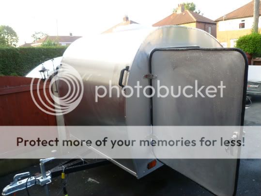

    After years of camping in tents,finally threw the towel in and decided on a teardrop trailer,could'nt believe what price they were asking or else it was cheaply made rubbish on ebay

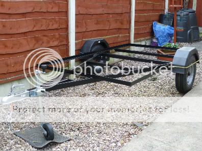

    firstly got mate to weld us up 7ftx4ft chassis

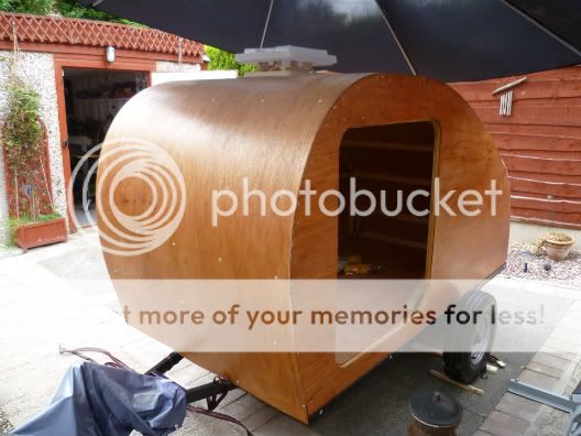

    Cut and shaped plywood frame

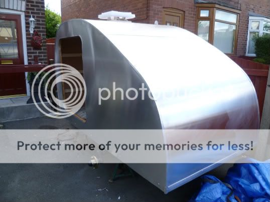

    cut aluminium outer skin to shape

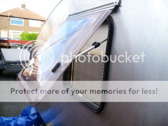

    Fitted window and door,insulated walls,roof and floor...Carpeted,built cubboard over bed.
    Ready for first rally,took trailer to weighbridge it weighed 220kg,trike weighs 540kg so around 30kg for cargo
    Have since built a battery box on Aframe for 12volt electric & light,fitted a CD/Radio...Awning for front...
