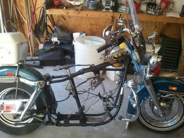

    Hello Everyone. Just thought I would share my winter project with trike lovers.
    I am rebuilding my father's custom built trike.
    The Frame is a Servi-Car frame - not sure of the year
    1972 or 1974 Shovelhead motor
    Cow patty transmission - hope to replace
    Narrow glide front end with dual disc brakes
    Fat bob - single tank style
    Mag wheel in the front
    Spokes in the back
    I am fairly mechanical but may be hitting these forums for tips and advice.
    I definitely want to put a longer front end on her and chop her out a bit.
    Here are some pics. First is just before I started the tear down. Second is at the end of day one.
    What do you think?

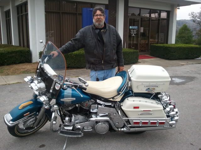

    Nice project ..I am rebuilding my 73 shovel as my winter project..I have a clymers manual and a Harley manual..Dont waste your money on the clymers it does not compare to the real manual..Has the primary been isolated? Chain oiler still hooked up?Good luck..<br />
    Before and after pictures..<br />
    <img src="http://i274.photobucket.com/albums/jj258/gun-works/1973%20Harley%20Shovelhead/2011-10-12103726.jpg" border="0" alt="" /><br />
    <br />
    <img src="http://i274.photobucket.com/albums/jj258/gun-works/1973%20Harley%20Shovelhead/2011-10-25153845.jpg" border="0" alt="" />
