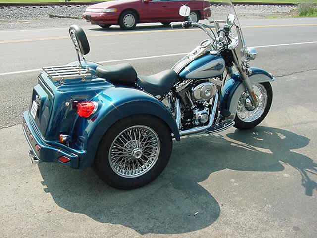

    You can use a Softail sissybar and backrest. You just need mounting brackets and make sure your rack clears the sissybar.

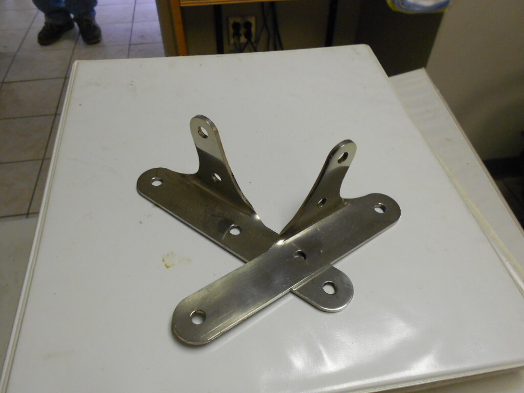

    These are the sissybar brackets that Lehman uses. You might be able to make some.

    Quote Originally Posted by =Stangas= View Post
    Hey Lee, (i assume that is your name.. LOL) Those brackets.. do they bolt directly to the fibreglass body and not the bike?
    They mount on top of the body between the ribs and forward of where the rack will attach.
    Use rubber washer beneath the plates to keep water from the trunk. Use silicone sealer inside the trunk to also keep the water out.
    You should mock it up first using masking tape to align everything before drilling any holes. Use clear silicone and chrome buttons to fill the holes of the tour pack mounts.
