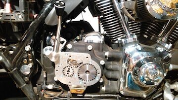

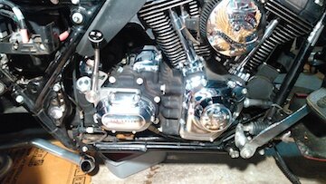

    Hi David. I'm not sure about an MMD reverse. I installed a Champion (from Papa Zook) on mine. It made the clutch cover about a half inch further out plus the width of another gasket. I hope that helps.
    Reverse assembly
    Assembly with cover installed
    Name:  reverse complete.jpeg
    Bill

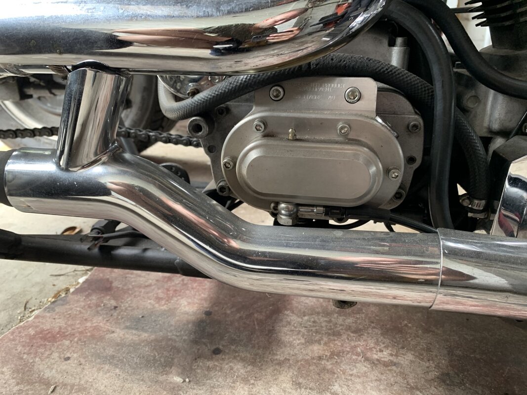

    it looks like im going to have to modify the ex pipe as the banjo bolt and line will clear thanks
    A couple of taps with a ball peen hammer on the heat shield will solve the problem....

    it will be the pipe the heat shield only covers the outside of the pipe not the inside where the bolt is thank you
