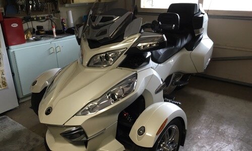

When I had my 2011 RT-L I could actually hear the gas boiling in the tank :xzqxz:. I took it to my dealer and they (since this is a known problem) installed vents in the body work up near the windshield. No charge :D. You can see the part in the picture below.
It's the black part next to the upper lights.
