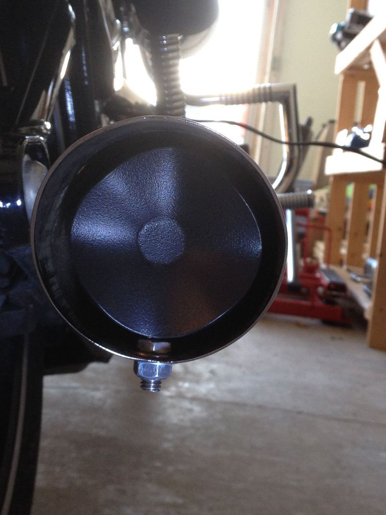

"I have a RGU w/ 4" slash cut Vance & Hines performance slip-ons. I removed the baffles to increase the sound and my safety. I lost torque and the sound was super loud. My buddy recommended the Torque Inserts and what an amazing difference in low and mid torque!!! I tried 3 different angles for the sound and decided to leave the inserts flat against the diameter of the pipes. Strong Sound! Deep and throaty."

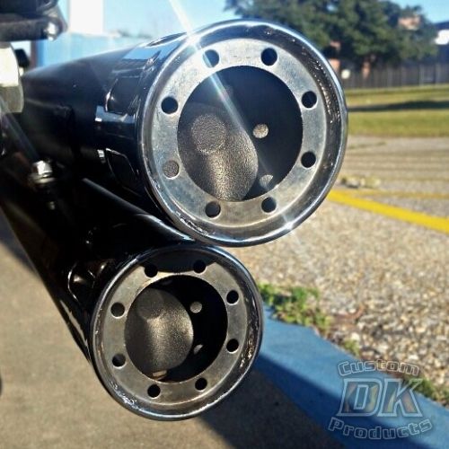

Installed TTI tonight - engine light came on
2021 Freewheeler. We pulled the baffles out of the stock mufflers and installed the W258 Thunder Torque Inserts. We left the packing in the pipes.
1. The engine light came on during the first ride. I'd be interested in anyone's thoughts on this as I wouldn't have thought that pulling the baffles would have changed the air/fuel ratio drastically enough to cause the engine light to come on.
2. And, the inserts are not centered in the mufflers. Is this a problem?
TIA
TIA
Have you checked for the diagnostic code that set the engine light?
TIA
Not being centered is not an issue.
Are you running the OEM air cleaner? OEM tune?
We will be having a 2021 on a dyno with a sniffer in a couple of weeks and will have a lot of info regarding OEM AFR and what can be changed out (air cleaner, exhaust) and how that effects the OEM AFR.
Yes, it would be helpful to know what codes triggered the Check Engine Light.
