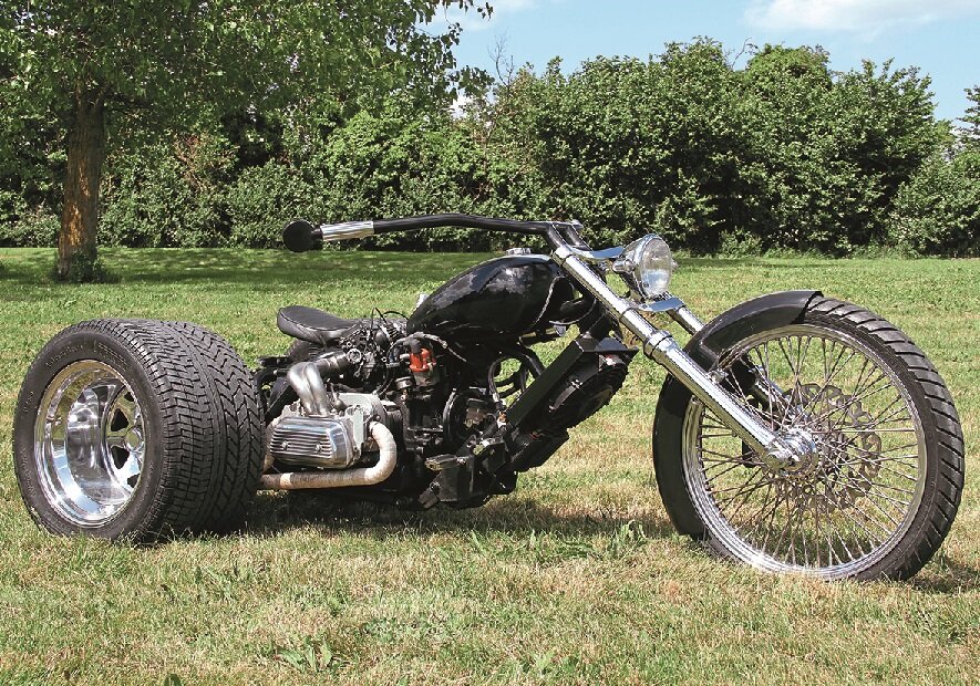

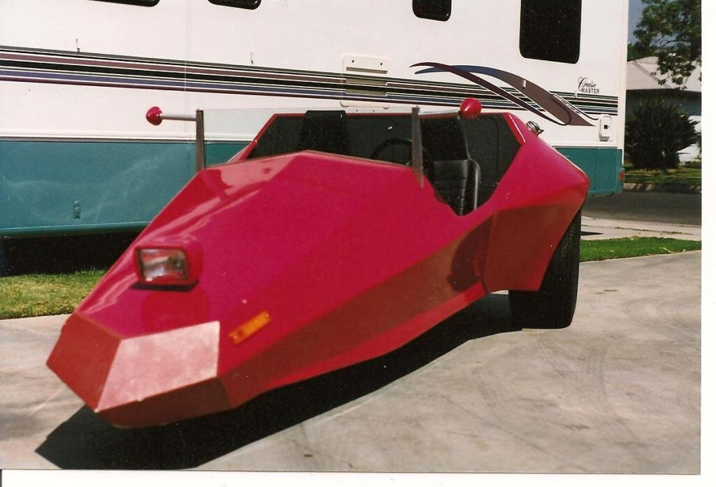

vw-mid engine.jpg-Trike VW mid engine.jpg-Mid-engine VW trike.jpg-Mid-engine VW trike2.jpgI would like to know how they do this Mid engine thing? I heard "BadAss" Used 2 transmissions, one was in reverse and the other regular 4 speed? I would like my next build to a VW mid engine???
None of the ones you pictures have the extension housing.
They may be mid engine.....but not front engine.
Go to the top of the page....where the sticky topics are. Click on the "Anyone Else" thread. That entire thread is about building a front engine with the two transmission cases.
I see that you "liked" the post but did not ask any further questions.
Feel free to ask anything vw trike here.
Here are a few things to consider about a front engine.
Most do not use the fan and blower housing.
Without the fan you MUST insure that you have strong air flow over the engine. And even then it is going to be difficult to tow or heavily load one without overheating.
I have seen (on the internet) several without the extension. As long as there is nothing in front of the engine they say it works. BUT most of them I have helped with had stuff blocking air flow......feet.....brake cyl...fairing....splash covers for you feet.....ECT.
Every one of those overheated.
The best way to go mid engine and no extension is to use the FULL fan and tins from a type 3 vw engine and never have to worry about over heating.
I run an extension housing and have mine straight in the wind with my feet up higher than the engine. It works..... but I doubt I could tow a trailer or go wide open all the time. I can burst out a massive amount of power and then cruise along and cool down. The wild temperature oscillations make it very hard to have a constant good carburetor jetting tune. (I am fuel injected)

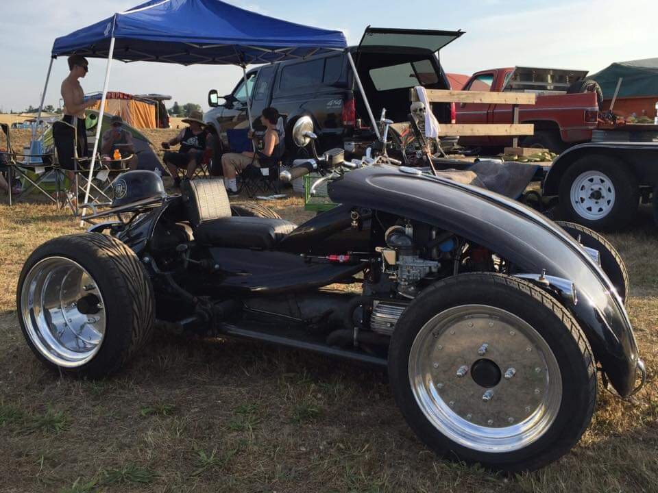

Thank you Rex, That's a lot to take in when I am a novice to the VWs except for the simple 1600 and clip to a 2x3x.125 frame. 1-Trike by TomyJ.jpg-There's more photo's in here some where. Have you seem the Ron Berg VW front engine Hot Rod? Drive shaft? OMG I am so sorry Steve, are we stealing your thread? DAMN!
