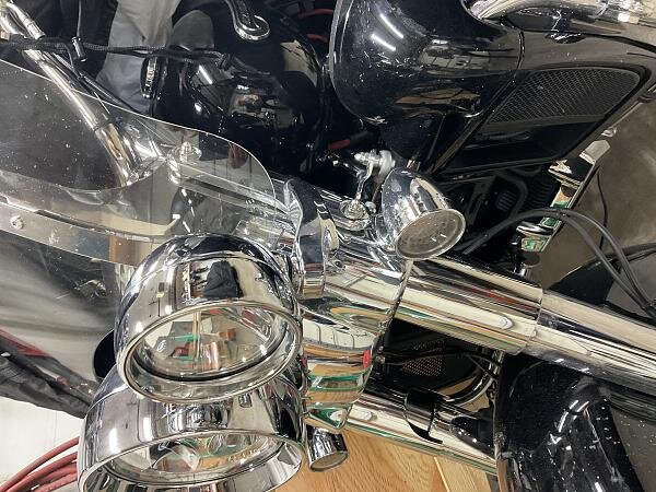

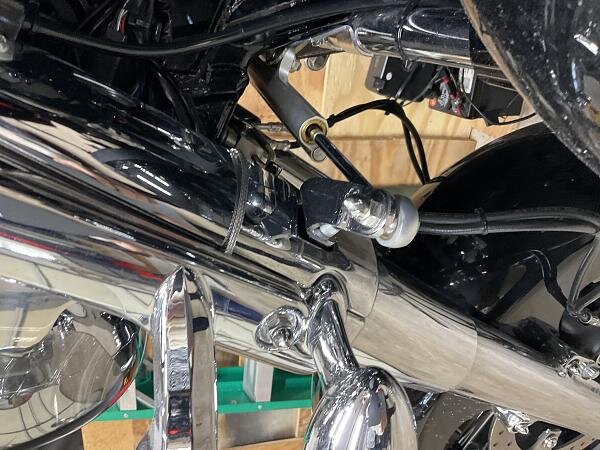

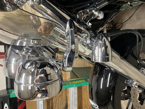

All the P&A Catalogs will not show any lights for the Freewheeler, but they do in fact bolt up. As you will see I did however, instead of drilling the nacelle side pieces I ran the wire around it in a chrome loom.

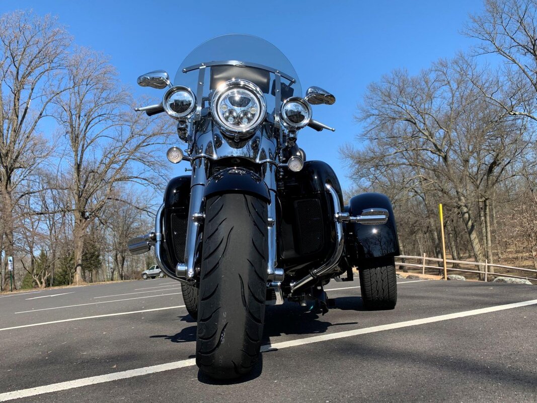

I installed these on the wife’s Freewheeler, HD # 69227-04A.
Not using the turn signal stand off’s and leaving the turn signals where originally located, doing so prevented the nacelle cover indents for turn signals with nothing to fill them looking ugly as &^%$!
IMG_2219.jpgView attachment 94299View attachment 94300View attachment 94301Freewheeler-1.jpg
