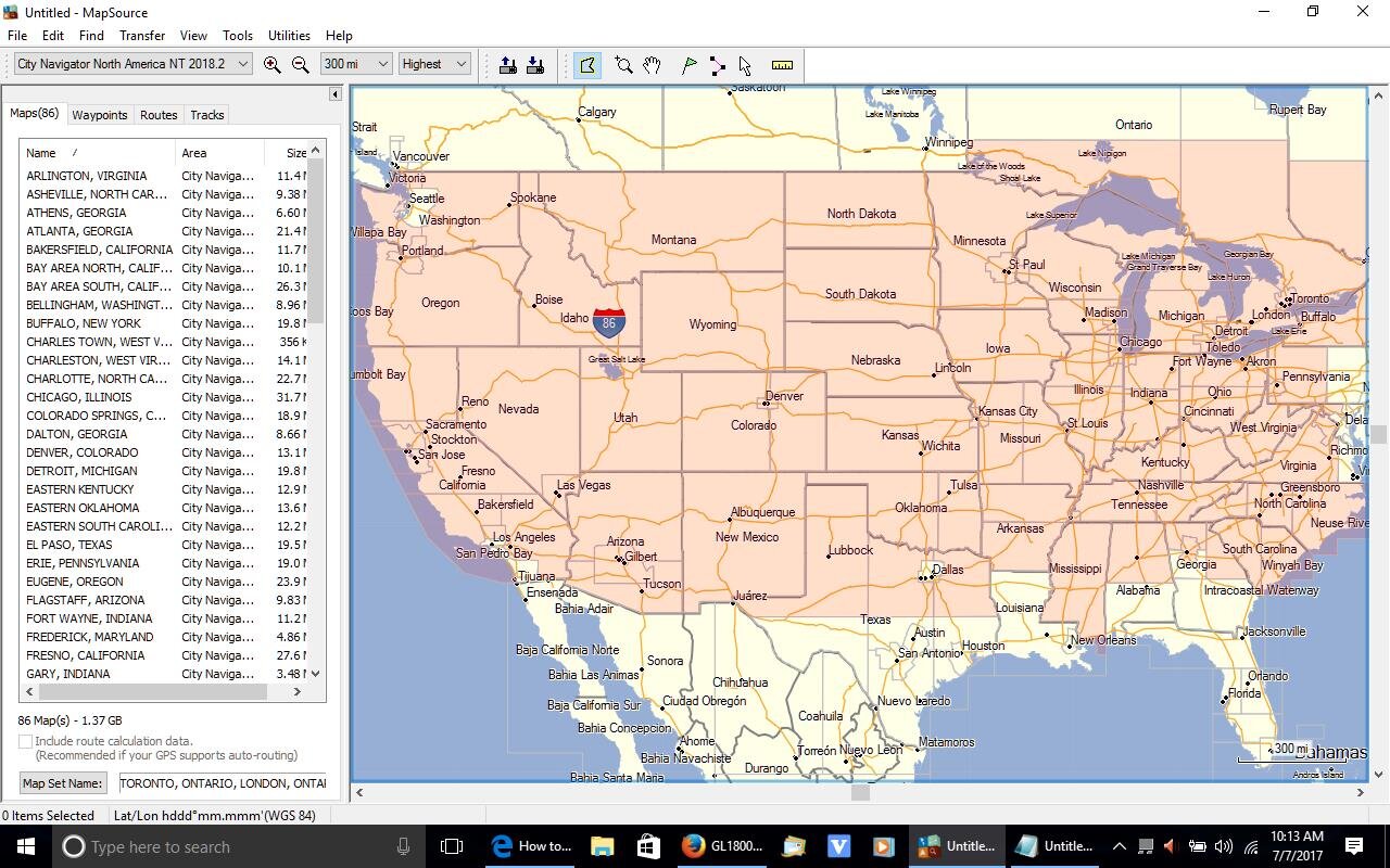

I give up. Got both map source and basecamp also City navigator North America and lower 48 states . These are "gmapsupp.img" unlock files. The North America file will not let me or I don't understand how to make a map set of just the lower 48 and the file that is just the lower 48 when installed into my wing nav says no map found.
Guess I settle for the 2014 version from Honda/Garmin and spend the $95 as I spent more time than that on my PC trying to make the damn thing work.

I GOT IT TO WORK:clapping: Re-name the file after it was unlocked did the trick. file was named gmapprom and renamed it to the old file name gmapsupp. Now I got my new map being read on my 08 Wing Nav system as 2016.10. Unsure if that is the latest but a lot more current than 2006 original map. Now if I could just figure out how to make the Map source or Base camp do what I want. Guess I do some research on YouTube for tutorials .
Glad to see you got it working. I know that the map file on garmin devices are named gmapprom.img but as you found, they are the same file as gmapsupp.img. 2006-2008 use the gmapsupp.img but 2009-up use the gmapprom.img. Simply renaming it works. The problem comes in with the size of the file for 06-08 GL1800's. If your gmapsupp.img file is over 2gb which I guess it probably is on 2016.10, you will probably get errors when trying to plan some routes. That is why I make my own mapset of the lower 48.
I have no experience with Basecamp although I have been told it works as well, I just always use Mapsource when creating my mapsets. To use Mapsource, look under the "Tools" selection and make sure to select "Map". This will let you start to select the maps you want to use on your mapset. You can either start clicking on the different parts of the map, highlighting them in pink (slower), or hold down left mouse button and drag the mouse cursor over the maps you want. it may miss some of the smaller sections or highlight some sections you don't want. All you have to do now is left click on the individual ones you dont want and left click on the individual ones that you want to include that didn't during the mass selection. It helps if you zoom in a bit and drag the map around to make sure that some of the smaller ones got selected.
Once you have all the maps selected that you want, it is time to create the mapset. Make sure that you're CF card is in a reader and connected to your computer. Click on "Transfer" and then "Send to device". It should find your CF card and then send the maps to your CF card. It is a long slow process so be patient. Once it finishes, you will now have the mapset on your card in the Garmin directory named gmapsupp.img and that will need to be unlocked to work. make sure to put your gimgunlock files on the card in same directory as the gmapsupp.img and unlock it. It seems a bit confusing but really isn't too difficult to do. Once you are done, the card can now be used in your GL1800 navi.
To check that it is working properly, once you have your GL1800 navi working, zoom all the way in to check if you can see local streets. If you can't, you didn't properly unlock the mapset or IIRC, the mapset is too big. That is the reason I only put the lower 48 on the card. over the last several years, the file size has grown as more roads are built causing the original gmapsupp.img to get bigger. And because the 06-08 have the 2gb limitation, Garmin now creates 2 OEM CF cards to use for this reason for the most recent maps. 1 is for US and 1 is for Canada. Depending on where you are, you use the proper card and then switch it out if you travel to the other location.
