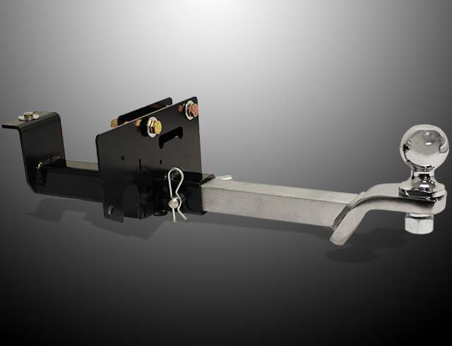

If you were to buy one from Motor Trike for an Adventure or Razor conversion kit this is what you'd get. Very similar to easytriker's
The one that came on my 2010 Motor Trike Adventure did not have the main tube going forward to an attaching point. I bent it the very first time I used it. What they offer now is very close to what I designed and built. Mine had a longer main tube forward of the weight carrying point. To me it gives more strength. :xszpv: :xszpv:
Do you have a picture of your hitch. That would be a lot of help
No, I'm sorry. Never took one. As I said it looked a lot like the one offered by MT now except the main tube came forward another 3 inches as I recall. The draw pin hole was in the same location. Just had more tube for added support. I also welded an anti rattle nut on the side of the tube so the drawbar would not rattle all the time.

My whole point in the post was .... I couldn't build one for that price and perhaps the OP could modify it to fit.:Shrug:
You are right!! Singer, Pin, and Ball would eat up much of the selling price and the main receiver piece could be used for sure.. POINT TAKEN.. :clapping: :clapping:
