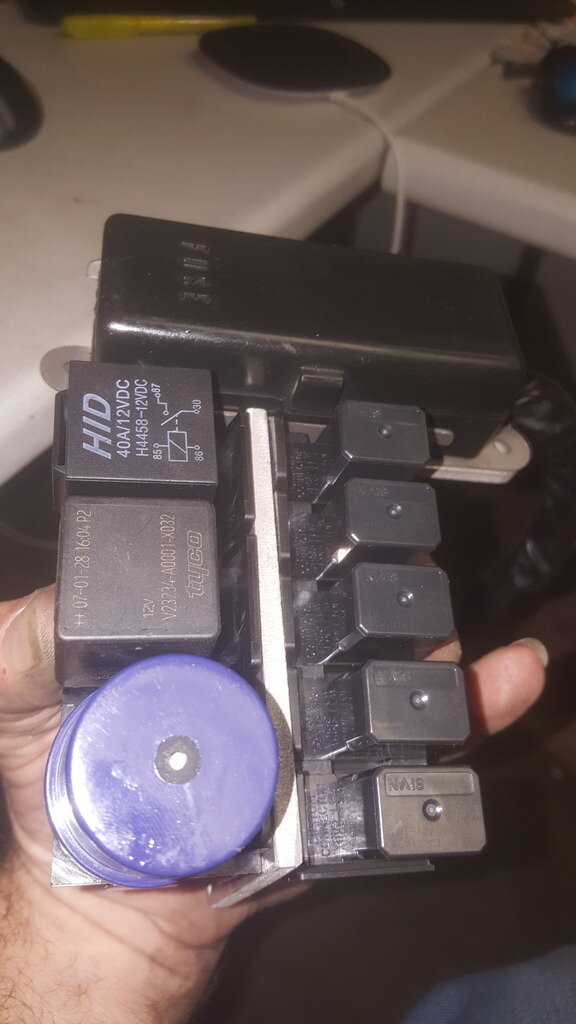

switch rew.jpgSonny... you may want to install a cutoff switch like this one (red handle) to cut all power when needed or to stop unwanted current drain. good info on the relays, I'm using at least 5 for various functions, and using about 6 more for a homemade turn signal system. there are cheap to buy and easy to use. Its worth your time to learn about them.
