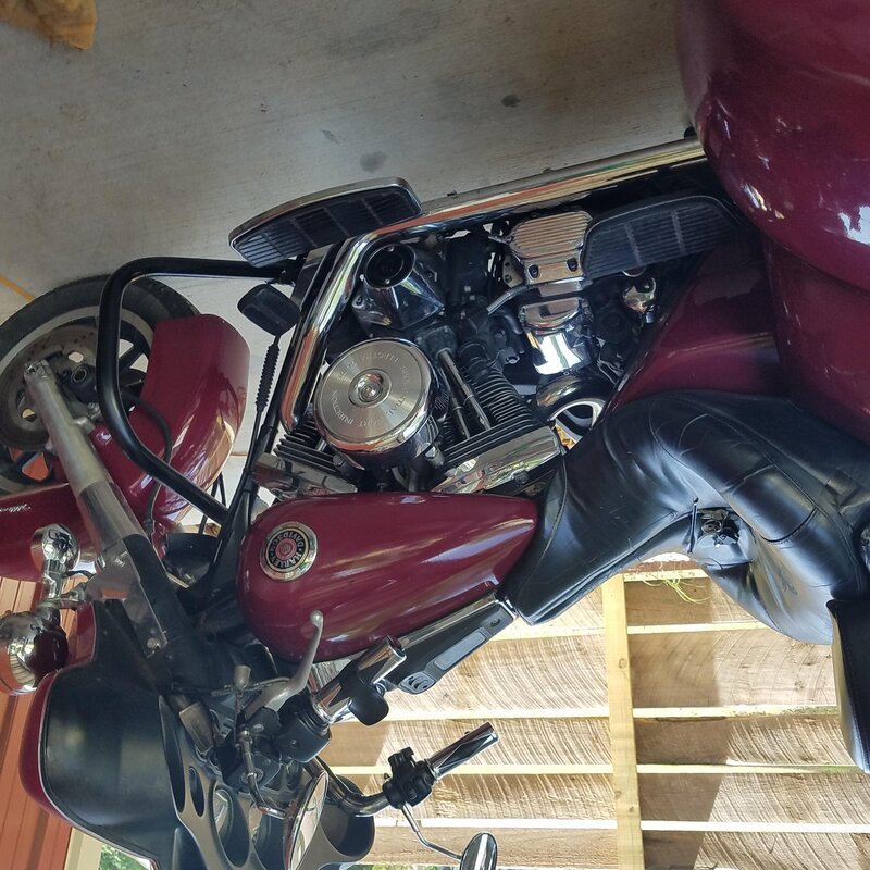

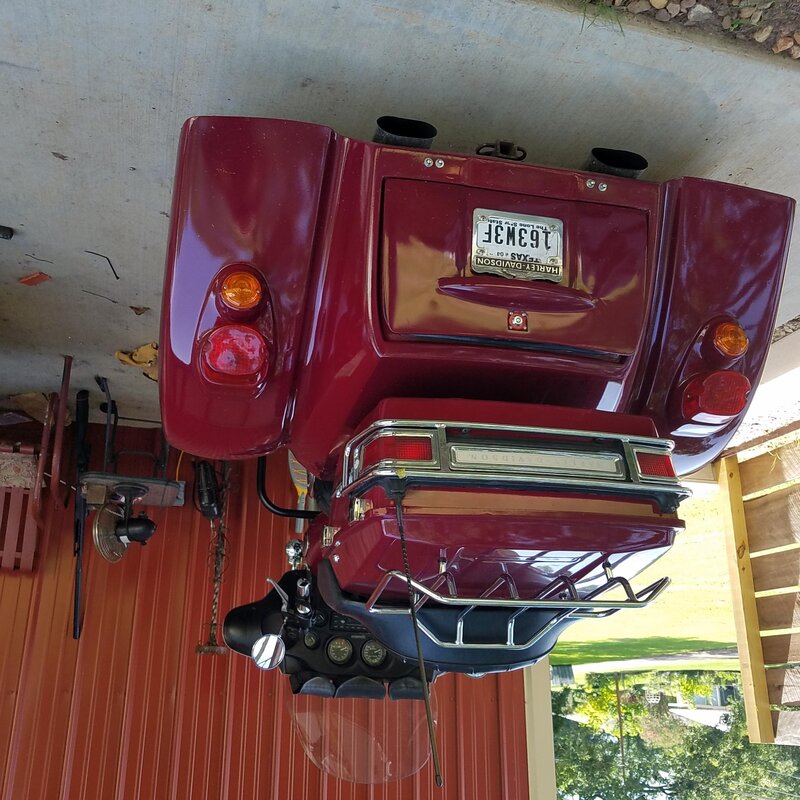

Have '98 Ultra with old Champion kit. Am in process of planning to paint. Fenders have clear vinyl fender guards that are dirty and cracking, sunbaked on. What is the trick to getting these off? I've been told goop or wd40 will release/melt adhesive.
Suggestions appreciated.
Goop.......Goo be gone...ETC Work well' Let it soak in for a few minutes...You will have to peal a little at a time and keep on reapplying the GOOP...
Thanks, Rhino. I will give that a try, although the top 1 foot looks beyond peeling off. Might start at the bottom and work my way up...
