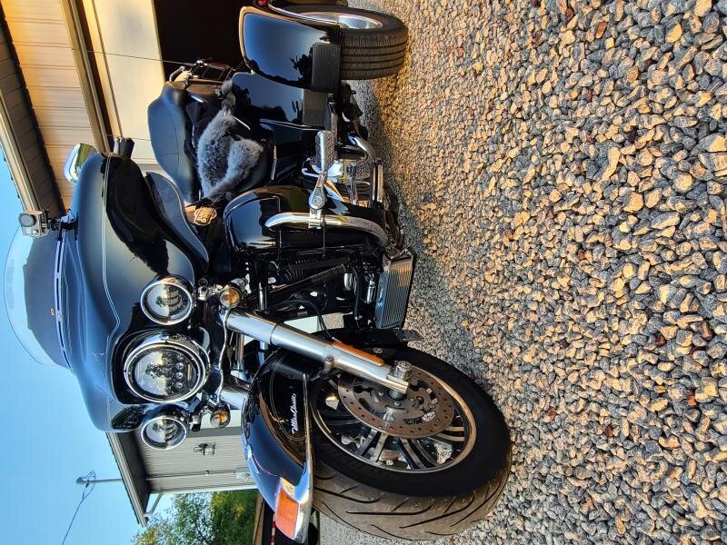

I'm running mighty mites love jugs from Trike talk cut n shoot customs . Randy is a stand up man great to deal with. Give him a call.20200702_200652.jpg
