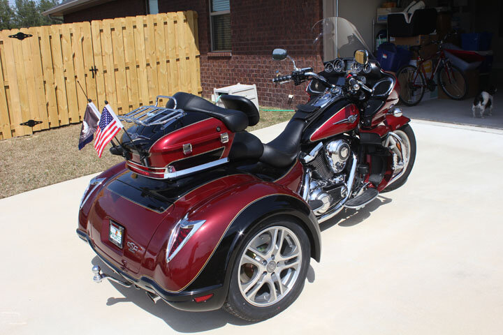

NICE ride! Hope mine comes out that well.

Looking forward to seeing pics of the finished ride!!!
