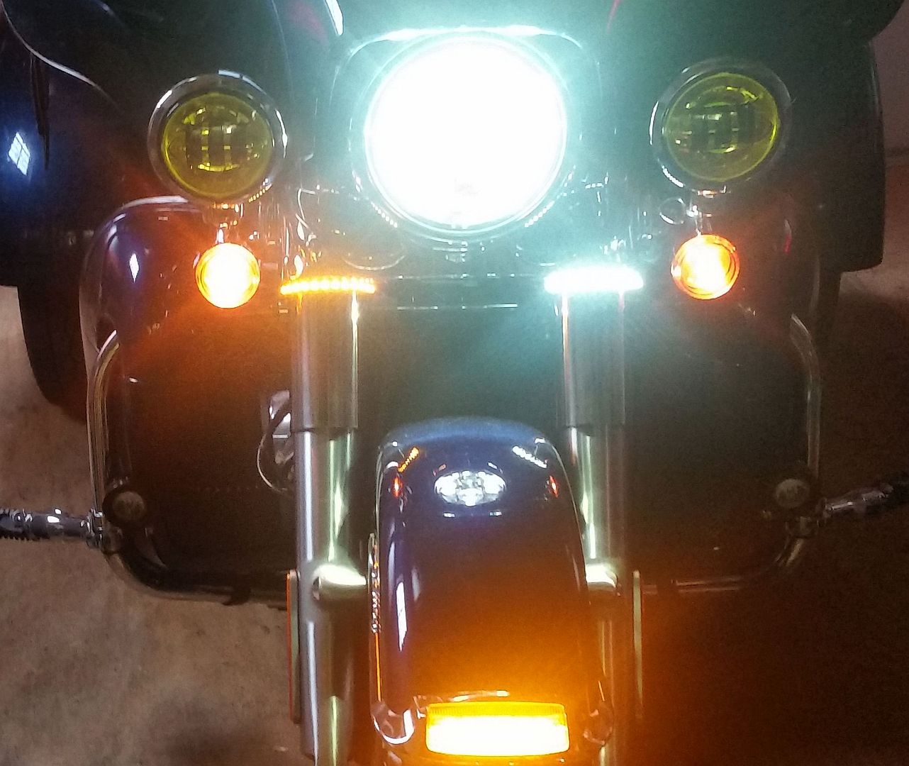

Here is the first-
White LED Running Lights/Amber Turn Signal combo.
I did not think I would like these too much, but Devin was hot on the idea, so he wired some up.
Turned out to be a super easy install, and I REALLY LIKE THEM.
The White Lights really increase visibility, day and night, and the turn signals are just cool. I have gotten a ton of positive comments from everyone that's seen them.
Not much to see when their off-
Full Daylight & on- The pic does not do them justice...they pop pretty bright even in the daylight!
Semi-dark, you can see they really put out some light!
When the turn signal is activated they go from white to amber, and flash with the stock signal lights-
Wiring was a breeze. Taking the side cover/bracket off the top of the fork, the wires were right there (leading into the fairing).
We used some Posi-Taps (pic below) and it was literally less than 5 minutes per side to wire up.
I like this mod so much, I am going to do it on my Softail also..but I am going to Remove the stock turn signals and run just these.
That is something I'm still considering on the Tri-Glide also.

The other biggie is...for those that are riding with the factory LED headlight, you may have experienced the same thing I have....when on high beam there is a large dead spot that is not lit up well between the bike and where the high beam is lighting up the road. These lights do a much better job of filling in that dead spot than the factory passing lamps.
Here's a pic in my driveway, all lit up.
Low Beam Headlight
Passing Lamps with yellow film
Stock Turn Signals
LED White Running Lights/Amber Turn Signal Combo
LED Driving Lights
See & Be Seen! The light treatment up front is almost done.

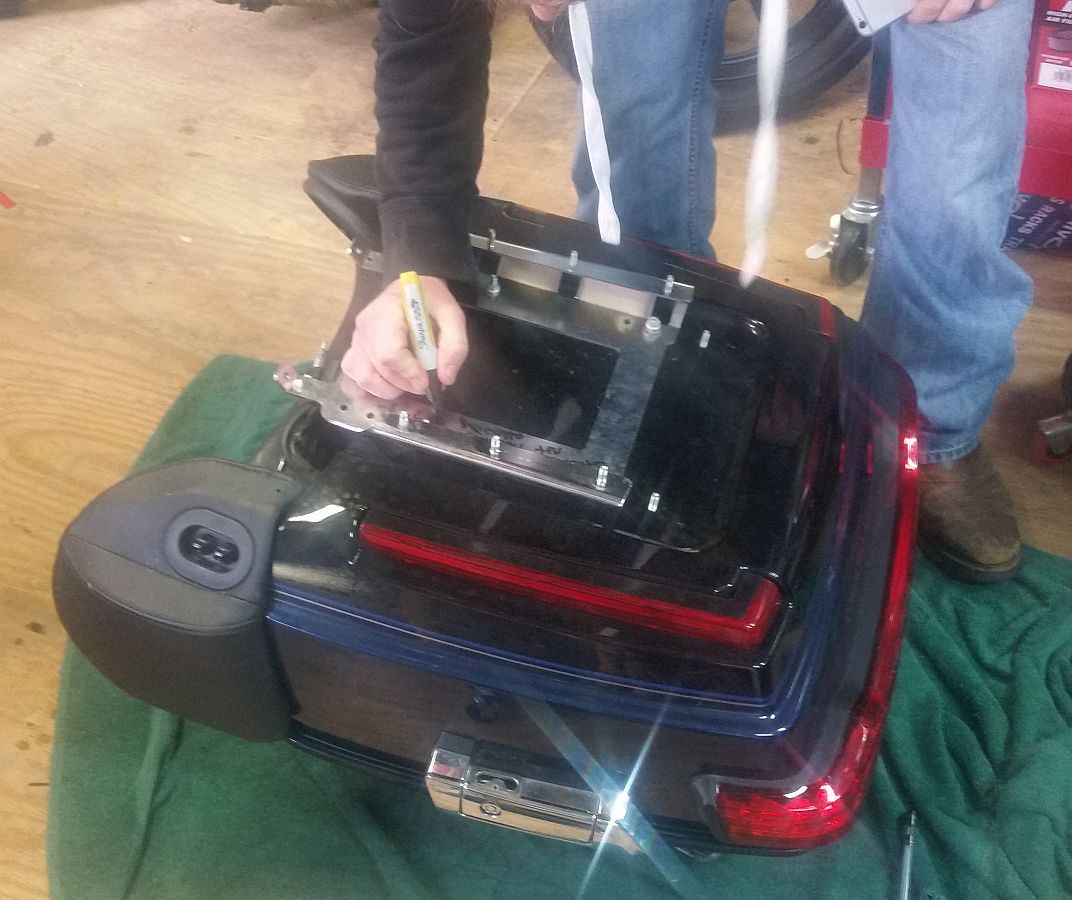

Today we threw out a bunch of metal!
We tried a variety of proto-types...did not like any of the results...and decided to start over.
Fresh.
No pre-conceived ideas.
After a couple of hours, and almost giving up, we had, what felt like, an "ah ha moment". ThumbUp
Time will tell. But we're pretty sure we came up with something that we're going to be real happy with.
We need to turn our sketches into CAD files, get some metal laser cut, and see if we have something that is great, or some more metal for the recycle bin.
In the meantime I will be riding the Tri-Glide with no Tour-Pak.
I think it looks pretty cool. Filled the holes with some bolts (sealed with nylon washers).
I'm looking forward to riding tomorrow and seeing if it feels any different....oh, Mary looked at it and said she has no interest in riding without her backrest. lol
Once that was done, we moved to the front. Pulled the outer fairing and had a look around, finalizing our last stage of front end lighting.
We should have more to report this weekend, or next week. :)
