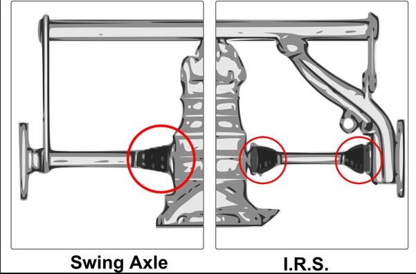

Is it an irs or a swing trans?

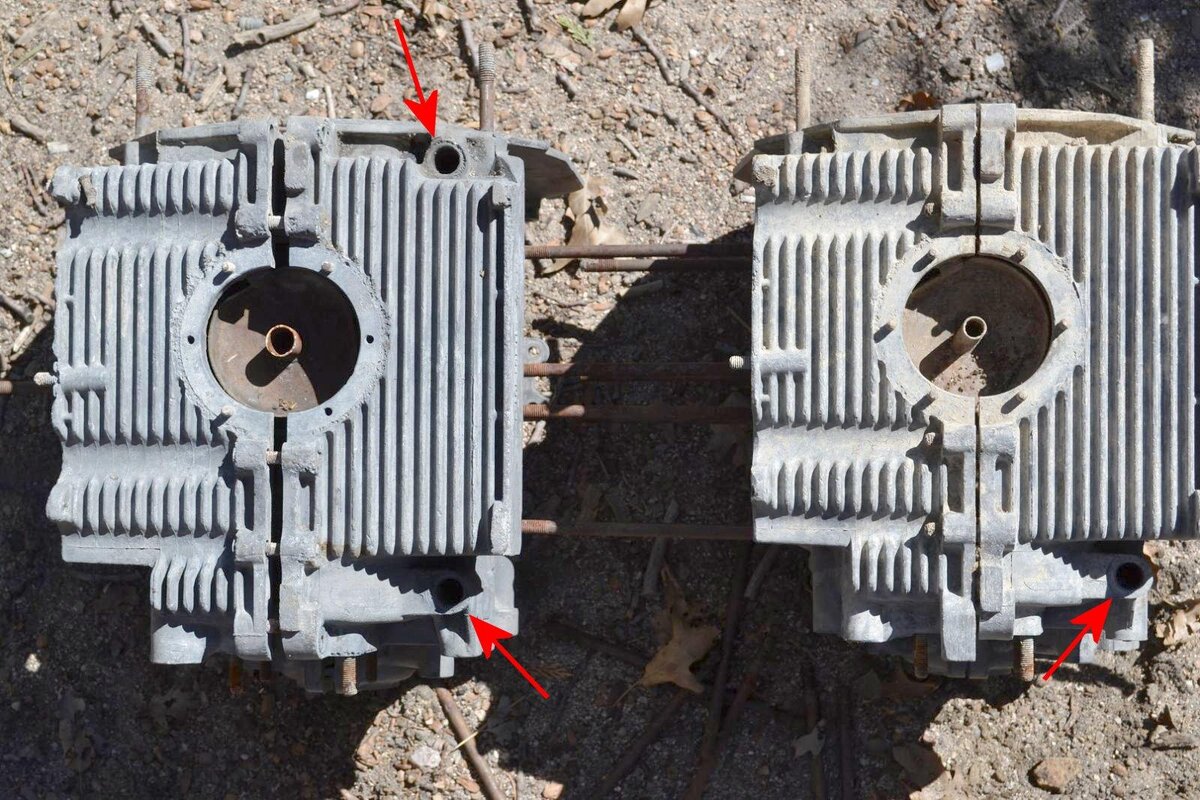

Is the engine case large pump studs or small?
Is case dual or single oil relief?

I dont know the diffenece between an IRS or swing trans.
