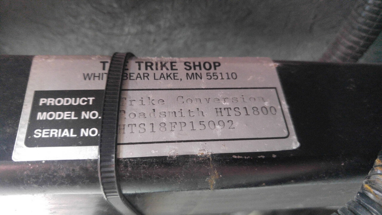

Welcome!
Take a look at the side of the hitch assembly and you should see a tag with the model and serial number.0723191109a-picsay.jpg

If you look underneath the trike conversion trunk, on the H-frame that holds up the trike body, there should be a foil label with the frame number of the conversion. If no label, look on the bottom of the 2.5" main frame tube, left side (in front of left tire). The welders stamp the same number series into that tube when making the frame.
