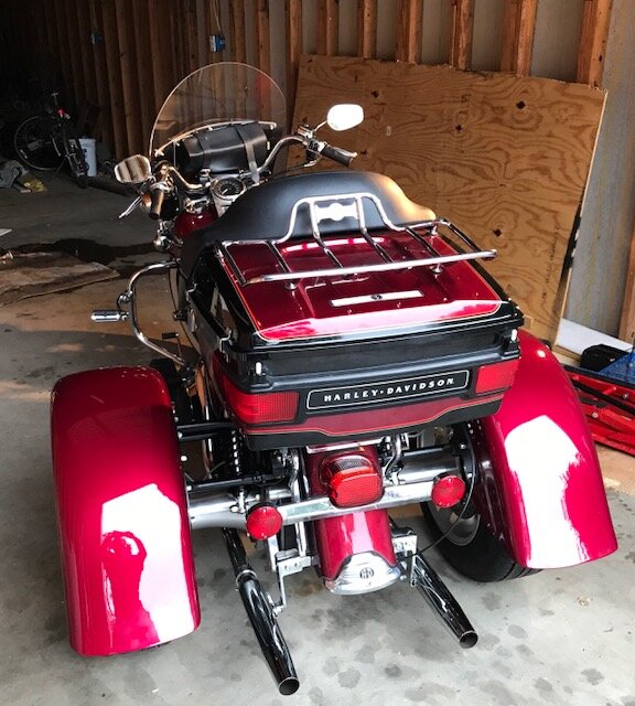

I finally have fenders
I went by Wednesday and explained to the manager that I was going to pick up my fenders Friday. I told him he had two options
1. Have them done and do a decent job, or
2. Give me a full refund and I would take them home and paint them myself

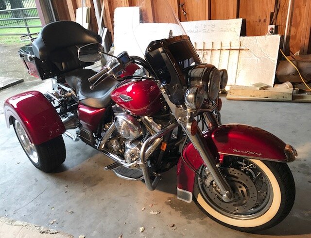

Surprise, surprise, they were ready. I'm going to undercoat them with herculiner this weekend and mount them next week.

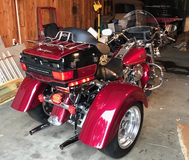

Here they are just resting on the wheels.
It only took a month to complete a 2 day job.
While waiting on hurricane Harvey....
Currently waiting on Harvey to get here, so I herculined my fenders.
Depending on what Harvey brings, I'll be able to install them in a couple of days.

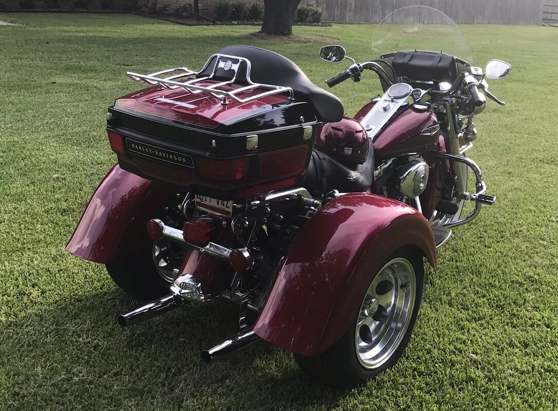

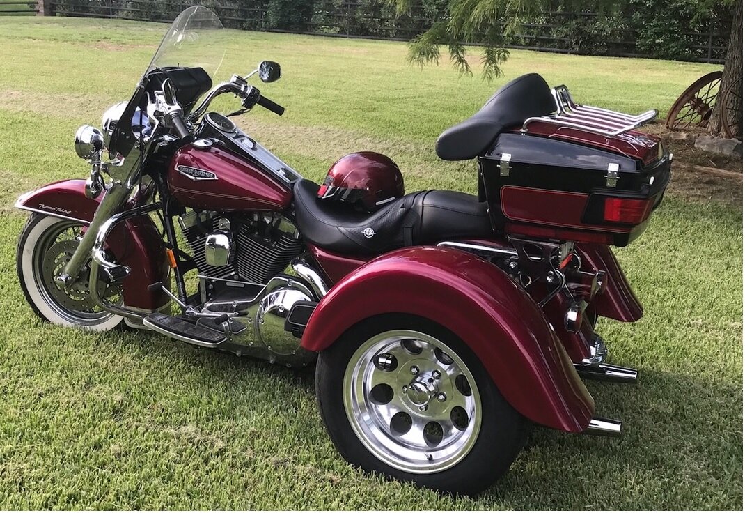

The sun is back out, the trike is done, and all is well. Below are a couple of better pictures, but I wanted add a few comments about the guys at Frankenstein Trikes.
I am very happy with the trike kit and had a lot of fun putting it together. I've had two people at work ask me if I traded the Harley in on a new trike. That speaks a lot about how well the kit goes together.
Throughout the process, the folks at Frankenstein have been extremely responsive. They shipped lightening fast and responded to questions rapidly. I had one damaged part, emailed the night I saw it was damaged, and a new one shipped before lunchtime the next day. Overall, the best service I've had from any company in a long time.
The trike rides great.
Hope to see y'all on the road some day.

GRR, You say the trike rides great. How much psi is in your tires? Also, can you easily identify parts so you can do your own repairs and buy them from an auto parts store? My Motor Trike was proprietary and I had to use the dealer no matter what.
I'm running 30 psi in the rear tires. Some people may want to run less. The rear end is a dana 30, so it will ride differently than your MT.
Frankenstein is pretty open about the parts they use. The brake calipers are HHI, so brake shoes and caliper rebuild kits are easy to get. The instructions even include the part numbers for the differential seal, differential bearings, axle bearings, and brake pads.
