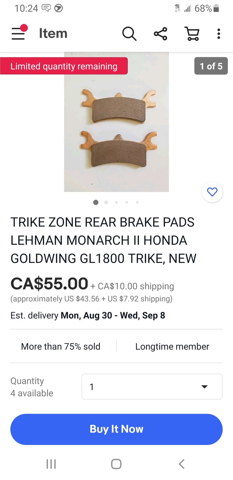

Jim welcome to Trike Talk👍👍
The calipers are Polaris supposedly from a Polaris ATV. The brake pads are available at bike dealers,Ebay and possibly Amazon. The rotors are from Wilwood from a Mustang II adaptation. You could possibly contact them about the parking brake pads. Theres a dealer in Illinois called Niehaus down in Litchfield illinois you could give them a try for parts . I know they have some what they all have I can only guess.
