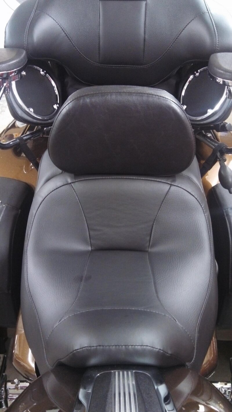

Went by the HD dealer yesterday while running errands and spoke with the one parts professional(he earned that title for sure) that is the most knowledgeable I have come across and he said the 14 seat(Hammock) would fit my trike. Even took the seat over to a stock seat on a triglide and it looked like a direct replacement other than removing the grab bar. I am taking the trike in on Tuesday to do a swap to double check and if all goes as planned my butt will be much happier! The 14 seat has the seat position I am wanting as the others do not.
Went by the HD dealer yesterday while running errands and spoke with the one parts professional(he earned that title for sure) that is the most knowledgeable I have come across and he said the 14 seat(Hammock) would fit my trike. Even took the seat over to a stock seat on a triglide and it looked like a direct replacement other than removing the grab bar. I am taking the trike in on Tuesday to do a swap to double check and if all goes as planned my butt will be much happier! The 14 seat has the seat position I am wanting as the others do not.[/QUOTE
Well I couldn't wait so I went back to the dealer today. The 14 hammock fits my 13 tri glide. I am one happy biker. What a difference between the stock and the hammock. The hammock sits almost identical to the 13 OEM seat but the quality difference is night and day. Much more comfortable. The OEM felt like I was sitting on a board and bottomed out on every bump in the road. I topped it off with a CVO lumbar backrest on the tour pack and also had to change out the filler pad on the tour pack as the CVO pad has extra support for the bottom area of the backrest.

Well, I installed my new 14 hammock heated seat today along with the lumbar passenger back rest('12 CVO style) and new lower pad of the backrest as that one is for that backrest and has an extra support area built into it.. I did install the paint guard kit first and you do not need the electrical harness as the 14's changed the female plug on the bike which is why you need the new adapter harness. The 13's remained the same and the 14 seat uses the old style(13 and back) male plug.
Thanks, that it explains it.
