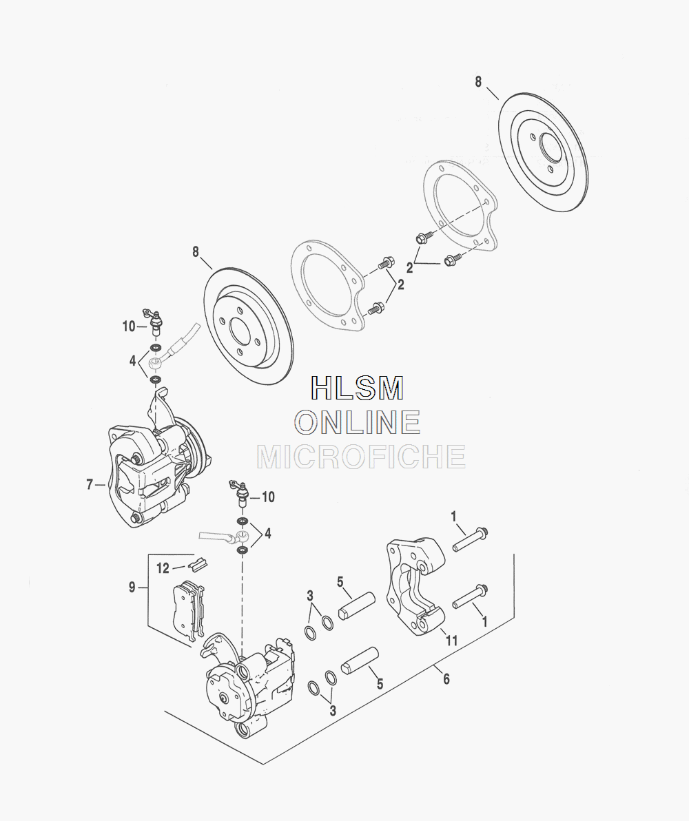

Your brake caliper and pads should look like this
