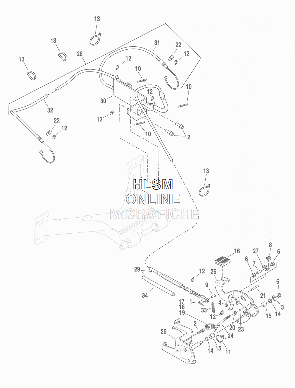

Adjusting Harley Parking Brake

Hold #29 with a pliars @ the front end , turn the barrel to adjust If you do not hold it the cable will twist and bind, the barrel should move toward the loosen nuts
