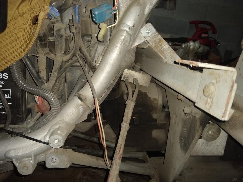

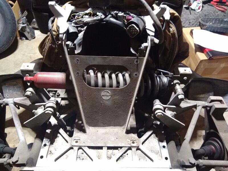

First of all, thank you all for your input. I had the tire run-out checked today and it was as perfect as can be. Changed the front tire anyway and there was no improvement. I have been paying close attention and trying to induce the wobbles under various conditions. What I did discover is that, with the bike parked, I can wiggle it back and forth using the passenger hand holds. When doing so, the motorcycle part of the trike moves a lot more than the trike fender area. So, shaking it may move the trike fenders 1/4 inch on the suspension. but the top trunk will move twice that amount. No clunking or other noises. But I may have some loose or broken trike conversion brackets or maybe even a failure of part of the motorcycle frame. I go in for exploratory surgery in a couple of weeks.....
Jim just for fun pull the side covers and check frame area underneath the battery and the corresponding area on the opposite side.
Will do. Thanks. I plan to get on my belly with a mirror and flashlight to look up-skirt at the trike. My thoughts at this point are, whatever is causing my problem has been magnified by steering head bearings, a hiem joint and A-arm bushings that were loose. Those are now corrected. I am committed to getting to the bottom of this and getting it fixed. Most of the time the trike rides good. At any speed I can slightly move the handlebars back and forth and the trike will fishtail. And this can also happen under certain road conditions all by itself. I do not like having unexpected anomalies in handling. Grrrrrrr.....
