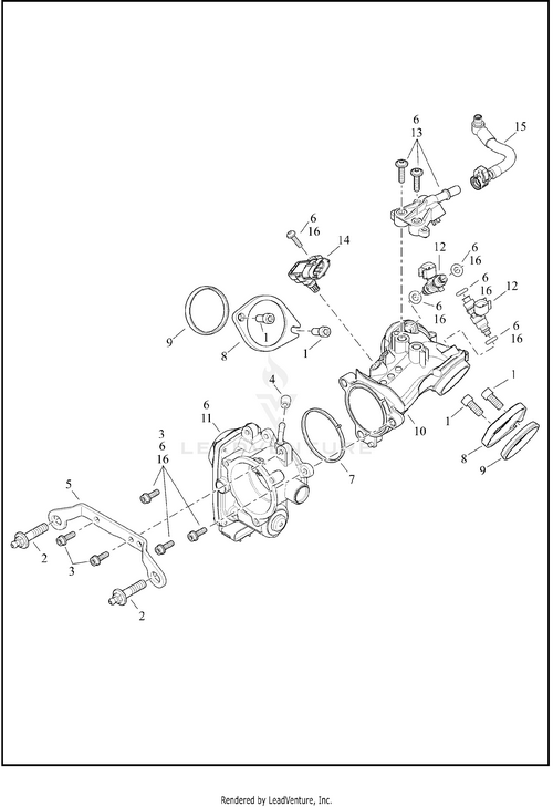

There is a metal purge tube on the top of the throttle body. It should have a rubber cap on it. Maybe it was damaged or knocked off during the air cleaner change. This will act like an intake leak.
#4 in this diagram
