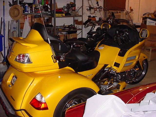

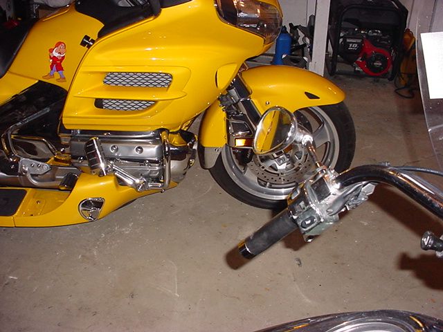

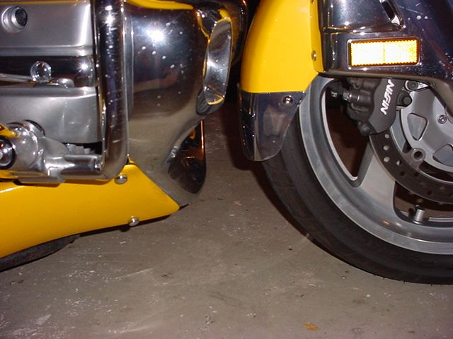

Since I dont really know what Im looking at so heres a pic or 2???

Based on your pics, Jay, I don't think she's been raked!!
I didnt think so.
Ive had in the past raked 2 wheelers and the stance is very different and has in my opinion the opposite effect.
Makes the bike more difficult to turn at times.
The fact that Im not having issues with steering this made me ask.
I thank you for your opinions here on it.
Jay I would also say it is not raked from your picture. Even if you like it now raking will make it handle a lot easier. I have riden many trikes both raked and not. Even though they handled fine not it was so much better raked. When you are ready to have it done may I suggest that you contact "Bazooka" the owner of this forum he will sell you a rake it at a price that is un-matched.

Looking at the pic you posted, without a doubt-It has (?????????) been Triple Tree modified.
*P.s. Edited---- Can't tell "Definitively" by the picture. Provide the measurement. @1.5"=NOT. @3"=YES
