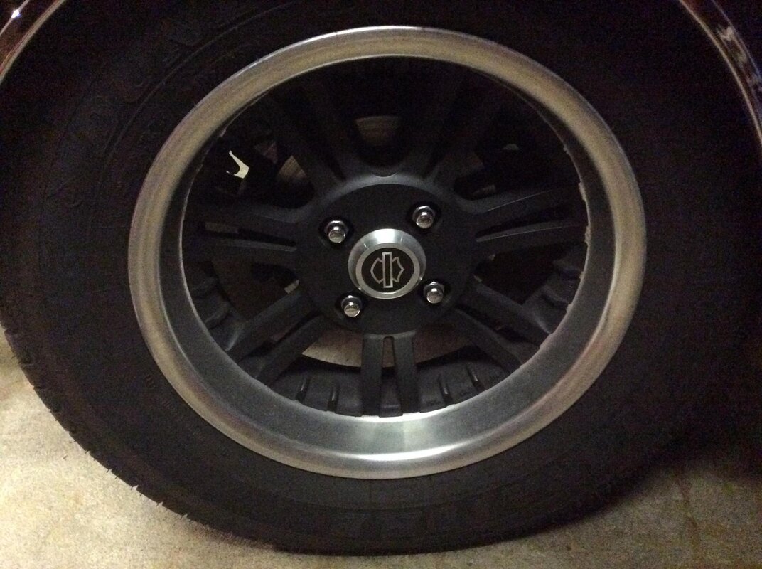

My turn , I gave up on the aluminum front wheel shiney
shiney thing. Rettlecan black the spoke part, scotchbrite the rim part, Front n rear. Soon to be totally black. D9C4F960-315E-44D5-AE47-02E92AA55D78.jpg

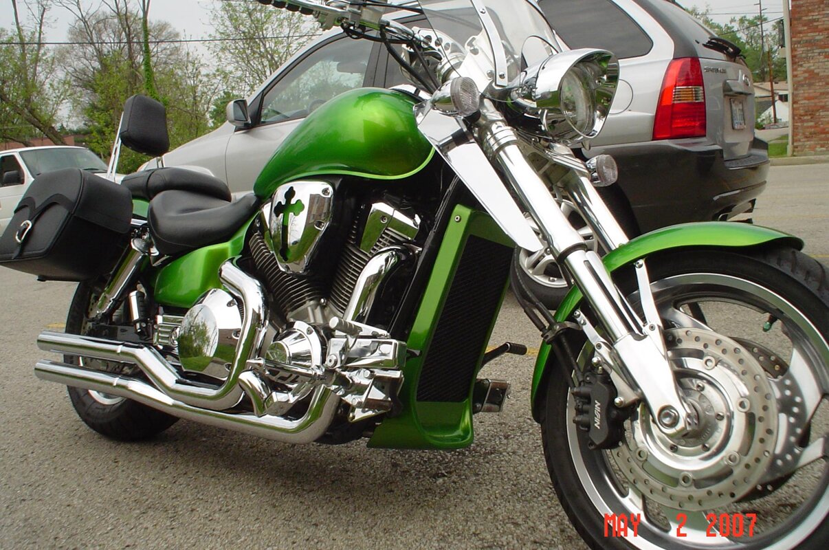

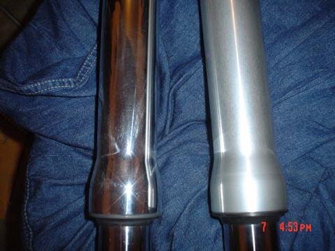

I polished the front end and rear wheel of My former VTX with an angle grinder and buffing kit from Harbor Freight.
I started with 800 grit sand paper and stepped up to 1500 grit then polished.
Very messy and time consuming job.
The wheels were a duller looking aluminum than the other parts.
Ken.

Wow! Sweet, looking job you did there!

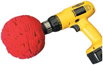

On my 1800 I used Flitz metal polish a drill and a polishing buffer ball. It really makes the front wheel shine. But youll have to work it a little bit if youve never really polished it before. I like the Flitz especially because of its silicone base makes it easier to clean the wheels when they get dirty and they stay shinier longer. I have billet aluminum rear wheels on my trike also and also use it on them.
I did it that same way and it does work. JUST START RUBBIG It take time but comes out looking great. BIG DENNY :clapping::clapping::clapping:
