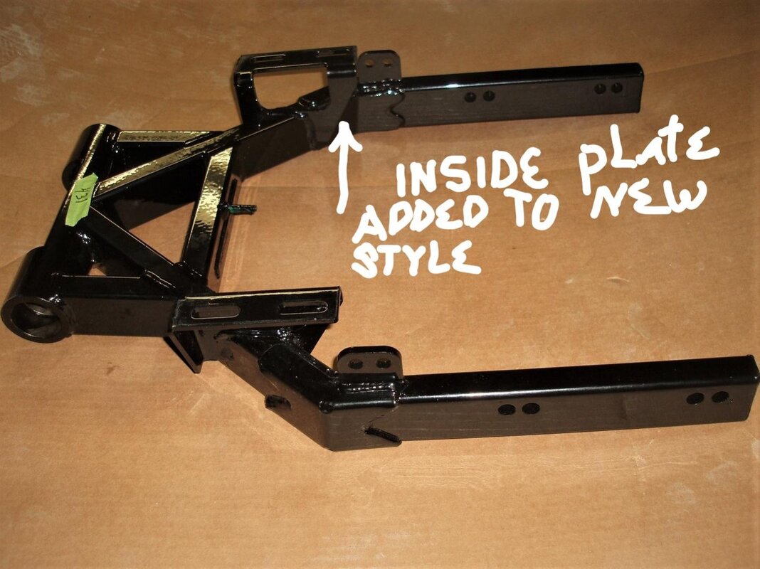

As far as I know, this was an IRS model issue only and was addressed by Champion a long time ago. I'm not sure of the exact time frame, but they totally changed the way the swing arm is reinforced. It is boxed on all sides now. I will post pictures shortly of one I am building now to show you all what the new part looks like.
Swing arm up-graded
Papa Zook You are correct on the new improved swingarms. The new replacement is also boxed on all 4 sides with what looks to be a little thicker metal ? The old style that cracked only had the 3 sided sleeve that appeared to be of a lighter gauge material? Welds also look better on the later style ? Time will tell and I'll add this "check swingarm" to other weekly checks (tire pressure, fluid levels, belt, ect.) Thanks for input!
