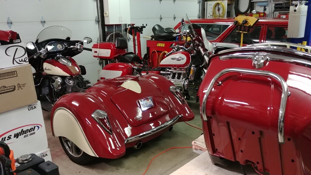

I just recently did this to our Roadmaster CSC trike. I moved it back and drilled new holes. However, the trunk on the CSC fits down over a raised area on the CSC body. This required that I also raise the trunk 1/2" so it would actually move back. I made 1/2" thick blocks from wood, sealed and painted them flat black. They really don't show unless you know they are there.
Looking at photos of the Motortrike conversion, I suspect you may need to do something similar as it appears the trunk sits right on the body. I assume they did something similar with a raised section molded into the body. The only way you will know for sure is to remove the trunk. Unless you can see it from inside the lower trunk compartment.

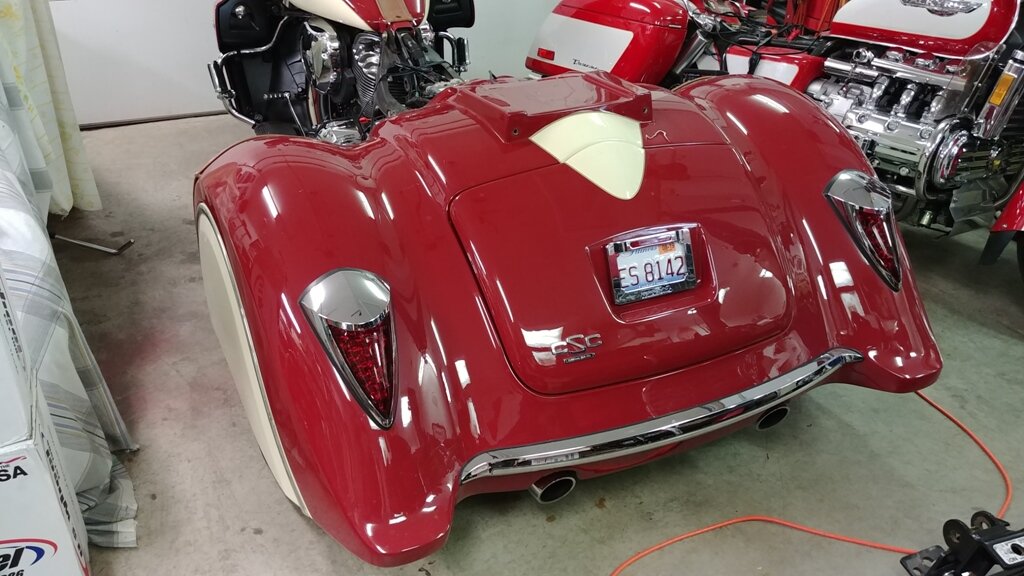

Here are a few photos that might help.
Note the raised area on the body.

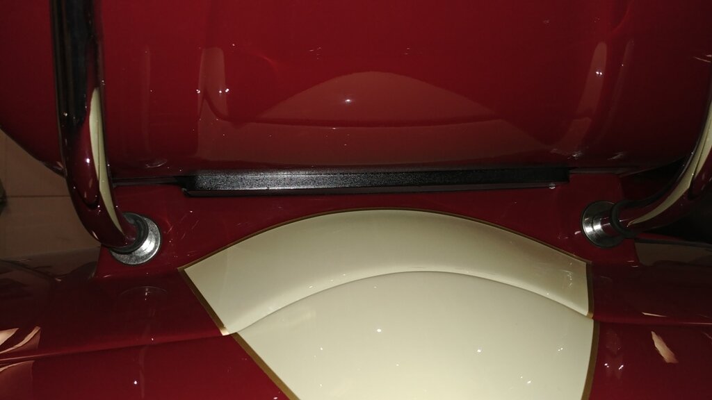

This shows the recesses on the bottom of the trunk that fit over the raised section on the body.

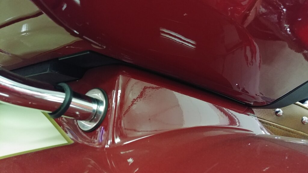

This shows the wood blocks. There is one in the middle and one on each side. They are barely visible and really only if you are looking under the trunk as my camera angle is. Also note I needed to extend the grab bar mount using chrome spacers. I noticed that Motortrike deleted the grab bar, so you would not need to address that.
Hope this helps!
