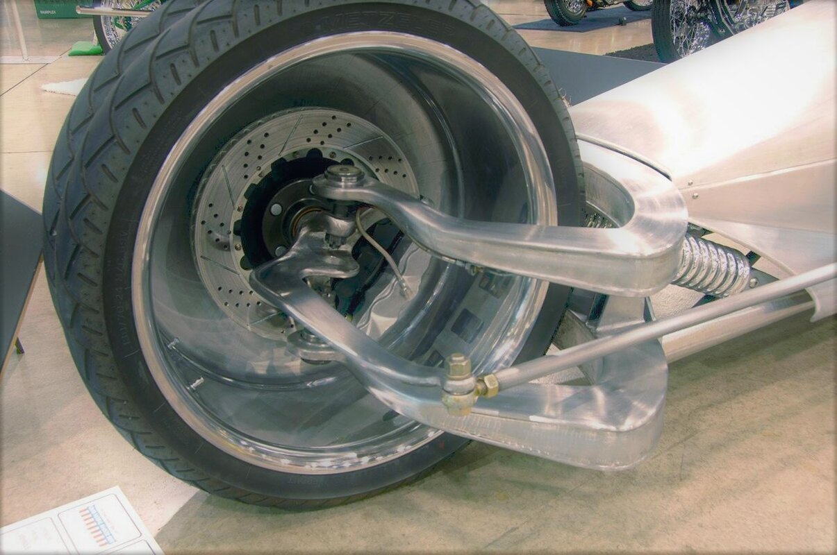

Anyone using a car rim on the front of a trike?
I already have 4 rims. Would definitely be easier to carry one spare tire versus waiting on a tow truck to get me from the side of the road.
Plus, I just like the look of a decent front end.

After several trips around the block with the all-terrain tire on the front, I've decided that it's not for me. Makes the front end way too heavy to steer comfortably.
Looking at an MC tire... https://www.bikebandit.com/tires-tu...ax-cruiser-and-touring-tire/p/30444?b=2812235
I've read that when running double dark on a motorcycle, with a rear tire on the front, it's ran backwards to the arrow. With running it on the front of a trike, would it be ran backwards as well? Or forward?
