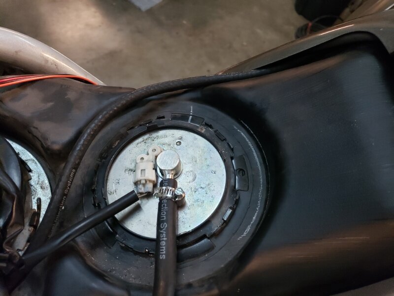

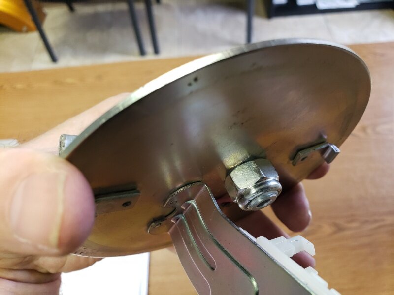

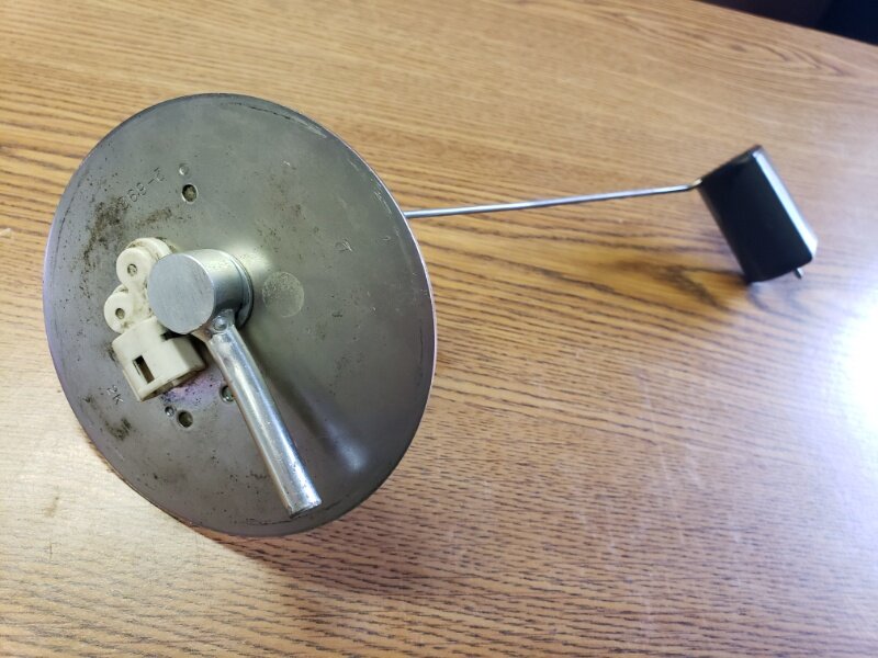

Jim,
What tank are you using? On the Roadsmith, the aux tank feeds fuel to the main tank via a fitting that they supply that looks like this. You drill a hole into the top of the sending unit plate, insert their fitting and screw the supplied nut on the bottom:
Papa Zook, what are the sizes of those fittings into the main tank?
Jim, I haven't put a caliper on one to be sure and Roadsmith doesn't list the size in their instructions that I can find, but the hose RS provides is gonna be right at or exactly 7/16" OD and the specs I get online for that size fuel hose show a 11.1 mm ID per the Gates fuel hose guide on O'Riley's HERE . I do know the hole that is drilled into the sending unit plate is 7/16" to accommodate the threaded fitting. Mike at Roadsmith can probably give you the particulars if you want to call him.
