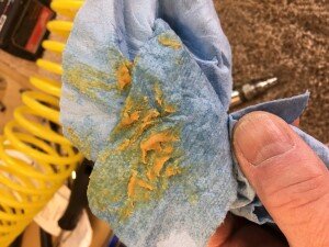

Went into the shop yesterday and with Jim's instructions followed the step by step instructions. Had to do the process three times and tice for the had brake as they haven't been done since the Honda GL-1800 was new. It never ceases to amaze me why folks think more about added bling to their rides rather than maintaining the equipment. The crap (excuse my language) that came out of the lines was well just that - crap!

This is what I am talking about, when you don't maintain your equipment. This came from the bottom of the rear brake fluid reservoir:mad:

Are you sure that wasn't from the bottom of a bottle of Gerbers squash ???? EWWEE !!:clapping:
Positive!

Good job on getting that nasty junk out of your system
I have always said too many neglect IMO one of the MOST important fluid on our bikes;)
