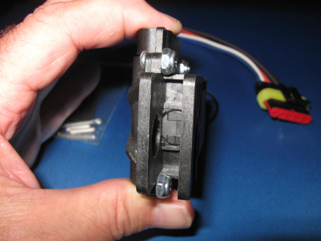

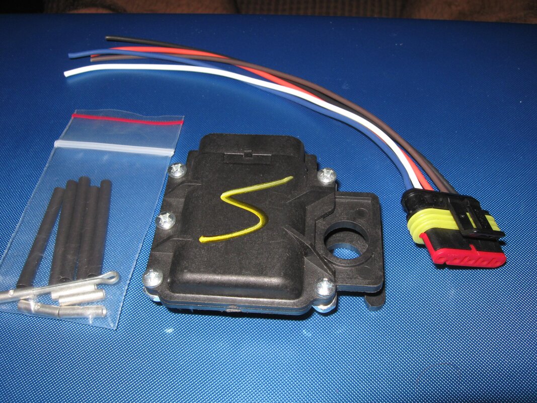

In the first picture shows exactly what a replacement brake light switch includes. I have gone through a switch a year for 4 years. tbms has replacement under warranty but said this was my last one. at over 250.00 a switch I am going back to stock at 20 dollars. my problem has been the plastic button inside the switch, the head gets mashed up and the button will not travel back and forth to energize wires. it is hard to see in 2nd pic.

That is the newer switch which all you should have to do is unplug and remove the old and replace with the new. Hopefully that will correct your issue. I actually took mine apart after replacing 4 of them in the early days and tweaked the thin blades inside to work with the plunger. Than was probably about 60k miles back and still working fine. Tomg
